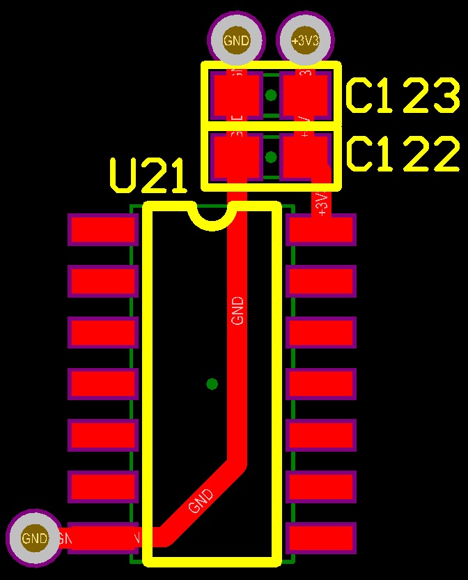

Ok, I see them. Do you not need for any for all the other IC's? The routing isn't too bad, but for the ground connection to the caps and device, you're dropping vias to your plane, which means you now have that added via inductance in the path. This is not particularly bad I guess, because your loop is pretty small, I just like to avoid vias in my designs for the decoupling specifically. I'd rather drop vias for the signal lines.

No, connecting to islands will increase your loop size. What I mean with eliminating vias around the decoupling, is to rather do something like this:
Then you pour your polygons/planes over that. It means your decoupling loop between the caps and your IC is the smallest possible, no vias in between the caps and the pins meaning your cleanest signal with the least inductance as well.
