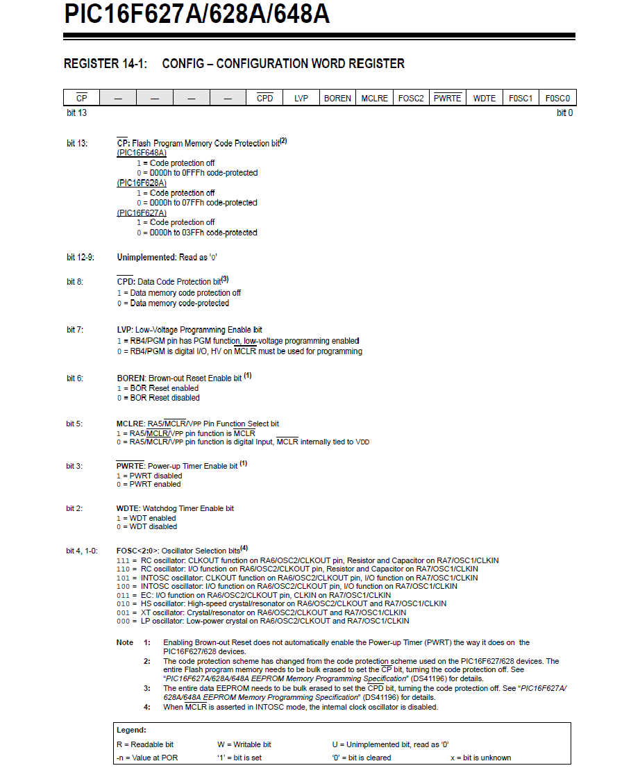

I'm starting to learn a little assembly??? but i think i had to much turkey, but what and where does the 0x3D18 relate to for the osc type, i've been reading so much my brain became cranberry sause this week :)
__config 0x3D18;sets the configuration settings
thank you
J.
Appears to be Int. Osc. with I/O on RA6, I/O on RA7 ........ ie Bit 4 = 1, Bit 1 = 0, Bit 0 = 0;
Page 98 of the 16F628A data sheet

thanks alot. I've been reading that data sheet all this time, i knew it was there but couldn't find it yet, but i also learned a bit more, now if
i can just remember it tomorrow lol. thanks again :)

thanks again all. i've been learning alot more, i must of read that data sheet 0xff times this week, i'm still trying to figure out how to get those numbers,???
in such cases i used to place the hex on winpic800 after selecting the chip and seeing the setting page, it reveals all the settings.
likewise while .asm file, on mplab also configuration reveals the settings once you select thee device. YES, experts are right that we should slowly get the habit of defining as elaborated by Blueroomelectronics.
I would name your configures but if you want to see how you get 0x0XXX what ever here how you do it find your page like the one I attached go to the bottom of the page
and start with bit O write it down go back up the list till you get to bit 13 you'll end up
10000100010101 = 0x2115
