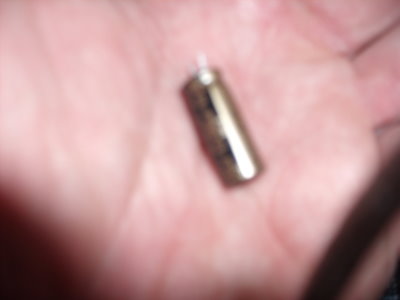

thanks for the reply and the welcome!! also sorry for not doing my profile i just have gotten to the point where i join so many forums i just hate doing it, but i fixed it to help better, to answer your question about size i not sure what size they are lol, but if i had to guess maybe one quarter inch high or long depending on if its standing or laying on its side, i will try to get a picture of it to help better and thanks again
erm... don't you know how to use a ruler ??? a piture won't help alot as your talking very specific if its a motherboard
problem is i dont have a ruler and payday aint til tomorrow but i also stated in another reply that i think its about one quarter in length
Use a dime for scale.

ok but hec not a ruler in the house ? as suggested you could use another object of known and recognised size to give us a reference (after all thats all a ruler is), if it were me I'd be using a caliper

this pic is not good but i would say it's what your looking for

yes that pic looks like it thanks for that :), and yes i do have money to buy them but right now im trying to find a local place that sells them before i go online :), and yes we are all broke in tennessee
EDIT: forgot to add that i managed to clean up the area on the motherboard where the caps had leaked but there is some that wont come off like its caked on or something would it be ok for it to stay there?
Probably not, if it's electrolyte high humidity may make it conductive enough to disturb the system.
