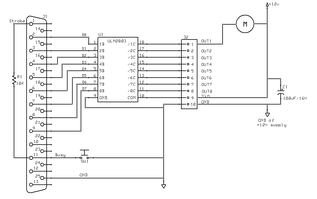

thanks kjennejohn, actually it is a school project, i would prefer to do of what you said about using parallel port drive transistor to control a dc motor with visual basic program. i would really appreciate if you can share some of your stuffs related to my project for me to based on??.. it will be a big help for me.
I supply a simple schematic. Get a pinout diagram for a typical parallel port to follow along.
This circuit as drawn controls one motor and has one input, the switch.
The ULN2803 is an 8-channel driver chip. It can supply up to 500 mA per output, but not all eight at once for very long as the chip would overheat and burn up. I am using the eight data lines out of the parallel port to control these driver pins. A high at the input pin produces a low out the output pin. A low to the motor starts it running. This particular motor is connected to a +12V supply specifically meant just for the motor. I don't think you should use the PC's +12V, but you can give it a try. I have a 100uF/16V electrolytic capacitor in this 12V motor power supply. I can't say how big this capacitor should be in the final design. Start with one motor and this cap size. If it works OK to start the motor smoothly, consider placing a cap in the circuit that is 100uF times the number of motors you want to use. Thus, if you plan to use four motors, that is four times 100uF, or a 400uF or larger capacitor. Install this capacitor right at the connector J2, across Vin and GND. You are supplying a burst of current to the ULN2803 to power up the motor when you switch the output pin on. Some experimentation is called for. One of the real pluses of this chip is the fact that it has the backlash diodes built into it. These diodes are needed for motors or relays. These devices produce a huge back voltage when power is removed. These diodes are usually added seperately across the motor or relay to redirect this back EMF back into the device itself, thus preventing damage to the drive transistor itself. This is why you need to connect the 12V to the Vin connection of J2. It must see the motor supply's positive voltage.
The grounds of the PC and motor supply must be connected in common at J2.
Pin 1 and pin 11 allows you to have a control input of some kind. Pin 1 (an output) of the DB25 connector of the parallel port is usually pulled high as a rule. We are using this 5V to make the resistor R1 (10 KOhm) a pullup resistor. This keeps pin 11 (an input) high until the switch is pressed close, which makes pin 11 go low. Your software must watch this switch and wait for this to happen, then go off and do something when it does. This switch could be off this circuit board. Just bring pin 11 out to a screw head terminal or pin that you can wire a remote switch or sensor to. Perhaps a limit switch to keep the motor from going over limits? Or an emergency kill switch.
That is it in a nut shell.
Have a nice project.
kenjj

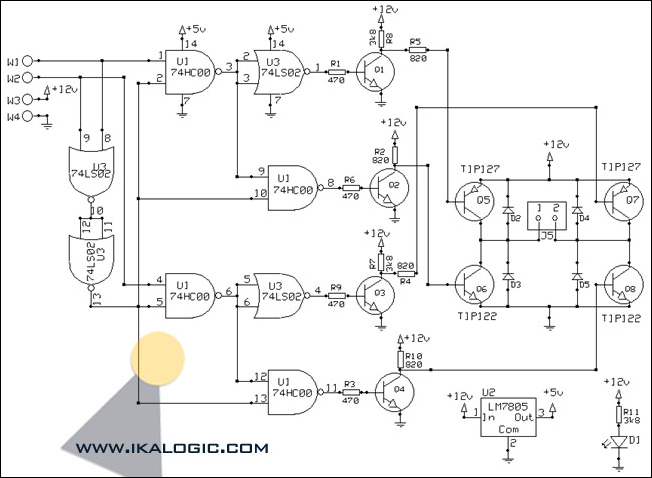

thanks, the circuit that you gave me is very practical and easy to follow. i have a question, is it possible for me to interface a 5A-hbridge motor control via parallel port. if its possible. can you teach me how?? thanks a lot bro...
Basically I just Googled using "5A Half Bridge" and found this right off:
I pasted the schematic from the article here so I could discuss it.
You'll see the four "W" connections on the left top. W1 and W2 will be connected to D0 (W1) and D1 (W2) outputs of the parallel port. The W3 and W4 are power inputs. The article has a chart showing the logic levels ("0" and "1", low and high) to be applied and how to use them to control the motor's direction, and brake it. If you plan to use a seperate 12V supply from the PC's 12V, be sure to connect its ground and the PC's ground to W4.
Notice the 7805 regulator "floating" at the bottom. This regulates the 12V in at W3 down to 5V for the logic ICs. It doesn't show the capacitors you need at both the input and output of the regulator. You don't have much circuitry so you can use two 1uF to 4.7uF (say, 16 WVDC) electrolytic capacitors, at both the input and output pins. That, and a 0.01uF ceramic or poly cap at both the input and output.
So, read the article, build the circuit, and have a nice project.
kenjj
