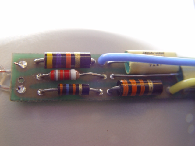

Hi gentleman,
I need to identify the fallowing component:
Refer to fig. 1
This is the middle component between the "big" 45k resistor and "small" 37 k resistor.
It has 5 bands:
Orange, White, Orange, Red, White
I am suspecting that it is a resistor, as it reads a value of 39 k.
By using Electronics Assistant I calculated it to be 39.3 k resistor, but it’s the white band that throws me over. As you can se it’s clearly white, not silver.
For my project I have to be 100% curtain, but I do appreciate any additional comments and feedback.
I did test it for "Diode" using a DVM, and I concluded a negative response, as it works bi-polar.

It is 39K. Put a 39k in the circuit and see if it works as before.
The red band indicates a tolerance of 2%.
Thank you very much... yes it a precise resistor and I believe that the white band indicates a temperature coefficient. Thanks for you professional advise.
