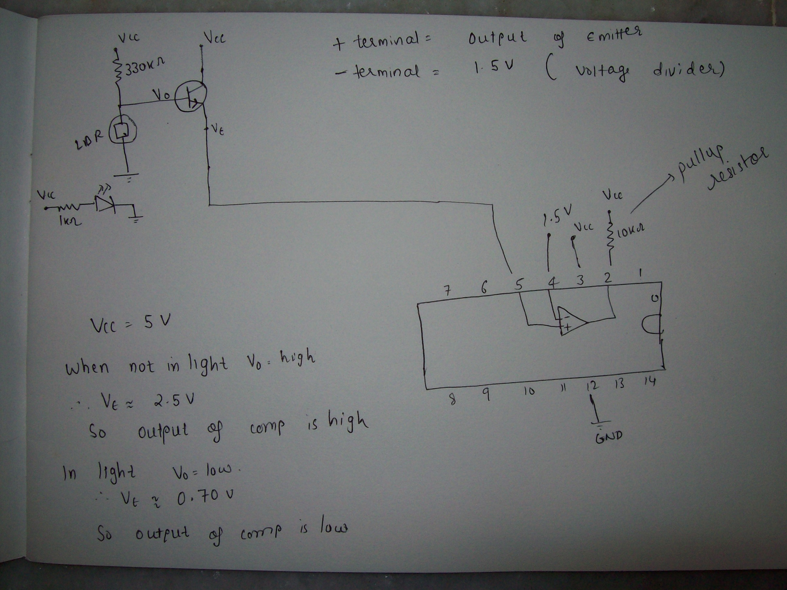

hi . i am using LM339 as a comparator. in + terminal i provide a voltage which is coming from the emitter of transistor BC548.the - terminal has 5 V. but this circuit is given error.when i use a multimeter and test the voltage between + terminal and gnd, the output becomes low. so anyone please help.

schematics
hi. i have attached the circuit. sorry i have not made it properly.
here my idea is that when the light of led does not fall on the LDR , the emitter output is high(2.5 V). so comparator will compare it with 1.5 V and result is Vcc. now when light falls on LDR, its resistance is decreased and emitter output is low(0.7 V). so my comparator will give 0 V as output.
now the problem is that when the +ve and -ve wires of multimeter are touched to output pin 2 and gnd to measure voltage, the output changes suddenly.the high output becomes low.

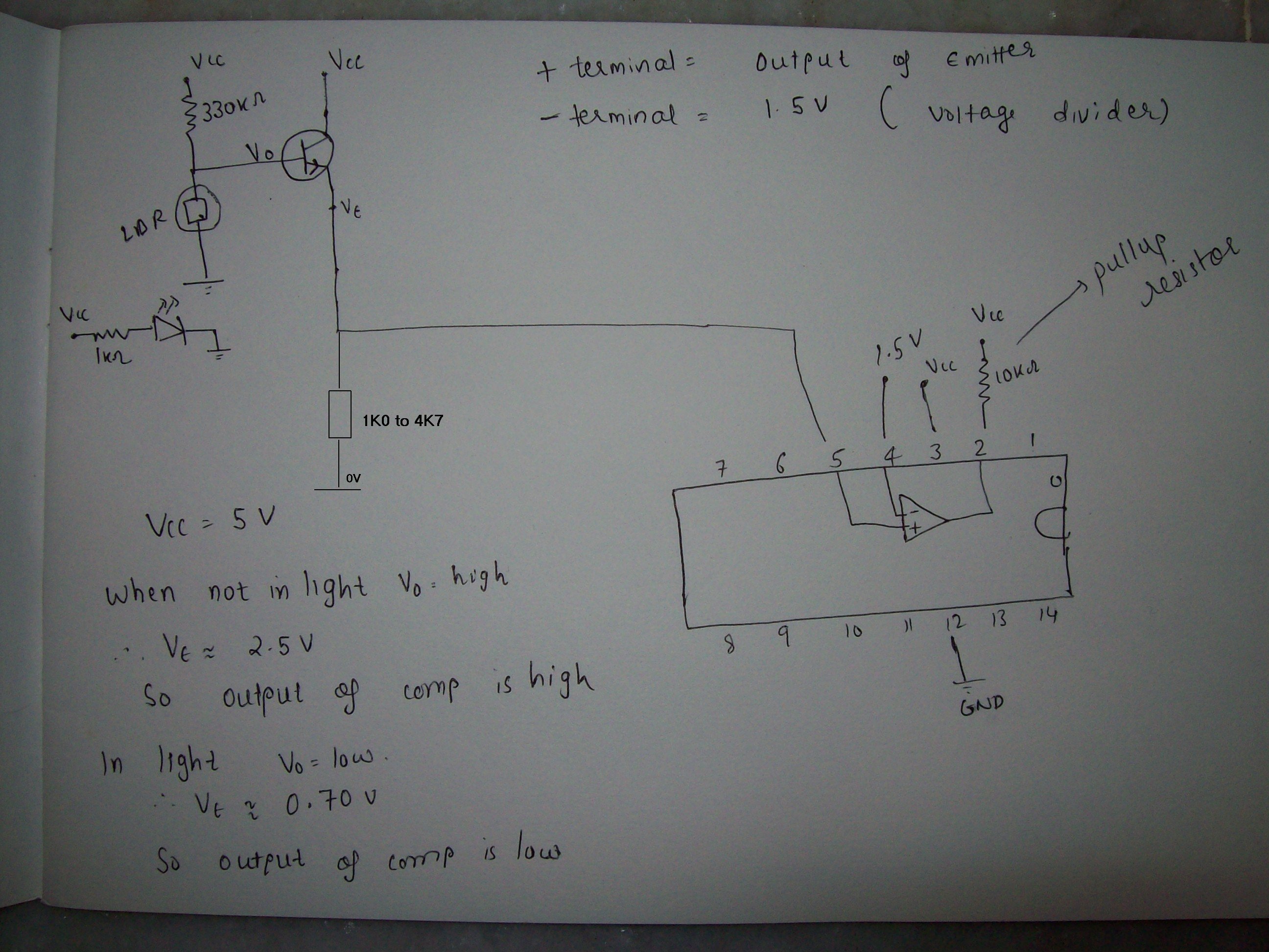

Connect a resistor from the transistor emitter to ground [0v]
A value of about 1K thru 4K7 should give a acceptable voltage change at +Vcomp.

And set a ref voltage on pin 4.

The OP has +1.5V on pin#4.
