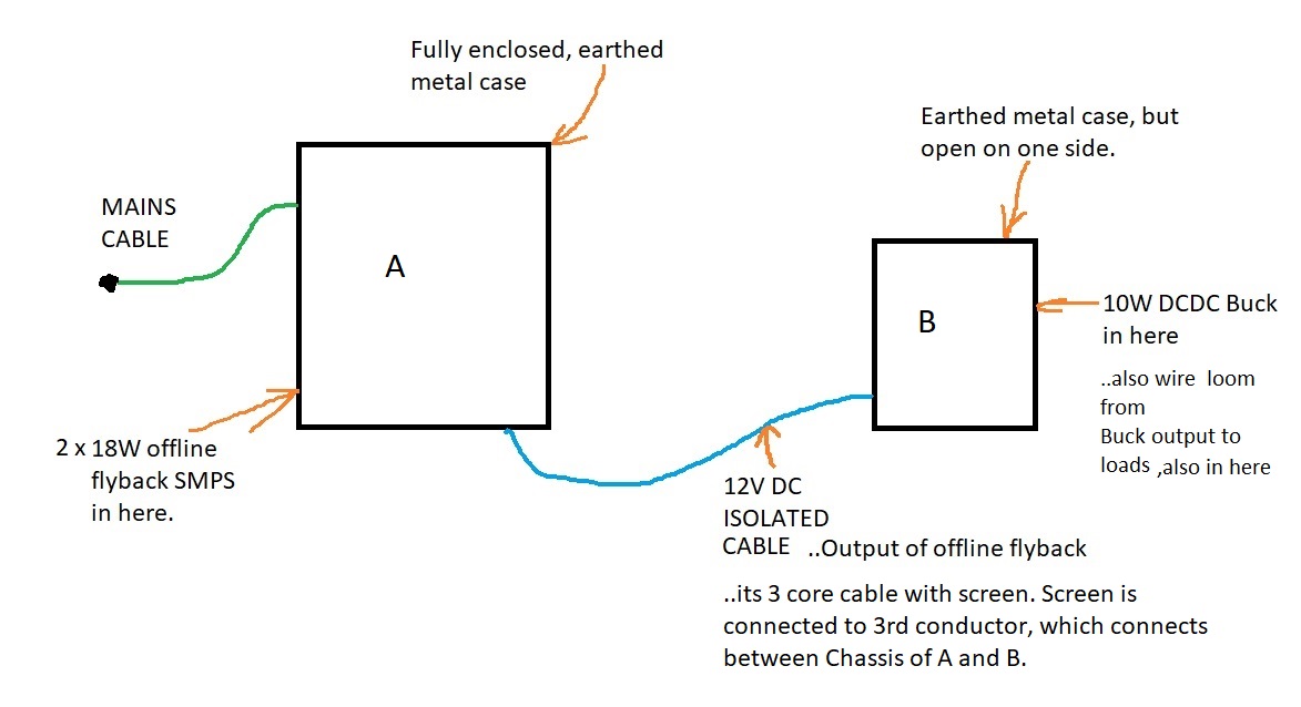

We have got to pass radiated EMC (30MHz to 1GHz), but in a “real” situation where what we cannot afford “proper” RF EMC techniques…and in truth…”real” EMC techniques just wouldn’t be mandated, or realistic.
Our setup is as attached.
The following doc calls for a “RF Reference plane” for use with EMC filtering and shielding….
…That sinks us from the start. We have two panels, whose metal enclosure is earthed, but that earth comes from the earth wire in the long 3-core power cord…..so that connection is so high Z to RF that its NOT a connection at all. So we have no RF reference plane!!!…and our metal chassis is basically floating at RF !!!
So straight away no official EMC literature is of any help to us!!!
Does anyone have an “EMC guide for real-life, cost constrained situations” document, instead of these “perfect EMC” guides which tell how to do EMC for super-expensive medical devices or military devices with RF gasketted connectors etc? I’ve read tons of them and they are no use.
I mean, Feedthrough capacitors, etc etc aren’t much use without an RF reference plane.
Take the blue cable between the two enclosures in the attached.
What are the options?
(a)…Two core cable unscreened?
(b)…Three core cable with third connector connected to chassis at each end?
(c)…Two core cable with screen…screen left floating…it may as well float…both our chassis’s are already floating at RF?
(d)…Two core cable with screen connected to chassis at “A”?
(e)…Two core cable with screen connected to chassis at “B”?
…and what if we just don’t bother connecting our chassis’s (A and B) to earth at all?....after all, the power cord earth connection is NOT a connection at RF…its too high Z. And then what should we connect our Y capacitors to?....there is no Earth. How are the common mode chokes working at all?
No EMC literature discusses these real options. Do you know the real answers?

Also, if a battery in A , alone supplies B,. then what if the A's metal enclosure is not earthed?....will it make the radiated emc scan worse?
