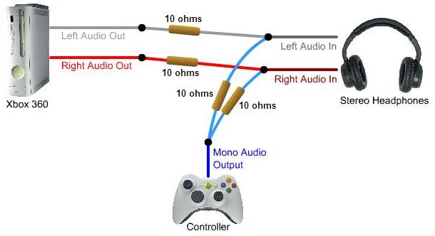

Hello everyone. As the title implies, I'm trying to to combine mono and stereo signals for a stereo headphone. I'm not by any means an electronics expert, so please have pity on me...
From what I understood in this thread ( I wired my gig according to the attached diagram, but I'm barely geting any audible signal.
Can someone please tell me what I did wrong here?

The link at the bottom of this page shows the thread. It uses resistors that REDUCE the signal levels and REDUCES the stereo separation.
In order to add together left and right stereo channels without signal reduction and mix in two mono signals then you need an active mixer circuit that probably uses an opamp.
Here is the very poor circuit from the other thread:
