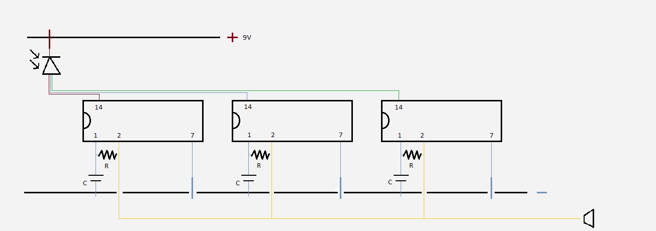

Hi there,
first off, I am new to all of this. I am trying to build a little device that converts light of different colours into music. The idea is to have a light shine on a colour sensor that's placed in a dark tube and the light being interrupted rhythmically by rotors with translucent 'blades' in various colours. The light sensor should be connected to a circuit and depending on the colour that hits the sensor, should trigger one or more of an array of little 'oscillator circuits' (not quite, see below).
I can post a picture of the device in case my explanation didn't help.
Either way, the device isn't the problem. My problem ist that I have not found a way to make the colour sensor work. I have no history in electronics so my knowledge goes as far as the descriptions in the Nicholas Collins book 'Hardware Hacking' (http://www.nicolascollins.com/texts/originalhackingmanual.pdf, if you are not familiar with it).
I would like to trigger a circuit with the Hex Schmitt trigger chip 74C14 (as he describes in chapter 18) with this colour sensor diode:
not precisely a matter of choice, frankly because it is the only one I can buy here.
my question is thus, is it at all possible, and how?
I have tried to read the spec sheet good as I can, but honestly I have no clue what I am doing. :sorry:
The way I put it together for myself is like this (see image), but it doesn't work, I thought maybe the diode doesn't output enough voltage to power the chip? Do I need a transistor? Do I need to wire it differently? Can I run a 9V battery through the colour sensor at all? Does it not react to light from a flashlight shone through a colour filter?
Any nudge in the right direction is much appreciated.
Many thanks!

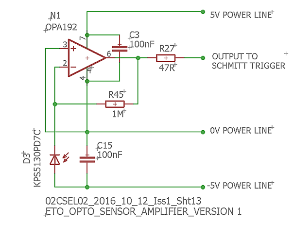

Considering the small size of the chip, with ~0.03uA at 100 Lux The feedback R's in your oscillator will need to draw less current to oscillate.
So 100k won't work.
Even 10M needs almost 1uA at 9V which won't work either.
Usually inverting trans-impedance amp (TIA), mode of amplifying current to voltage is used to produce voltage which you can use to drive your Schmitt Inverter oscillators. Choose Op Amps that work with inputs at/below ground with very low input bias current and expect time constant to be slow with very large R values for gain.

As Tony says, the key will be to convert the minute current from each of the three color sensing diodes to a voltage high enough to flip the Schmidt triggers and turn the appropriate audio frequency oscillators on.
As the frequency of turning the three color sensors on and off is relatively low, this presents few problems. A current to voltage converter using an operational amplifier will do the job. I would recommend the Texas instruments OPA192 family of opamps, or the similar but slightly less accurate OPA197 family.
If I get the time, I will see if I can knock you out a schematic.

Hi again GabeChan,
An outline schematic of a current to voltage amplifier made from an operational amplifier is attached below.
NOTES
(1) The pin numbers shown on the schematic are not correct for the OPA192
(2) The output voltage = opto sensor current * R45. R45 can be adjusted to suit the sensitivity that you require.
(3) The -5V line takes very little current, so a couple of 3V CR2032 button cells in series will last for years (-6V will be fine).
(4) the capacitors are for decoupling and should not be omitted. The values are not critical.
(5) Unless otherwise stated (UOS), all capacitors are disk ceramic X7R dialectic.

I am a bit confused about the placement of the diode. I thought reverse bias has to be applied to the diode which would then be fed into the schmitt trigger ... but here I cannot see how the diode can act as a gate for the whole setup...? Also, especially since the diode should have three anodes, thus three outs, one for each colour, which in my schematic would be fed into the three different triggers.
Could you elaborate on that?
I am also confused about one of the resistors. R27, what purpose does it serve and what value would I need to pick for it?
Also, I am based in Germany and I can neither seem to find the OPA192 nor the OPA197 at the biggest (and only) German circuit parts retailer (www.conrad.de) ... can you think of an alternative that might be available here?
This doesn't account for the resistors and condensators I use for the schmitt trigger, right? everything in the schematic goes before the schmitt trigger, correct?
The diode is reverse biased: it has zero volts on it cathode and -5V on its anode.
The diode conducts current when the right color light shines on it. The schmitt tigger requires a voltage of around 3V to trigger. The operational amplifier does the job of converting the minute current from the diode into a voltage sufficient to trigger the schmitt trigger.
The diode does not act as a gate. The diode only conducts current, as stated above.
the diode should have three anodes, thus three outs, one for each color, which in my schematic would be fed into the three different triggers.
This is a question of semantics. The 'diode unit' contains three different and independent photo detector diodes, one each for red, green, and blue. I have confused you by drawing an outline schematic which only shows one of the diodes in the diode unit. In practice, you would have three opamps and three Schmitt triggers, making a total of three outputs.
:) You should be confused by R27 because it plays no part in the functional operation of the circuit. It is an isolator to reduce the capacitive loading on the opamp output and help to ensure that the opamp responds well and does not oscillate. The value is just good practice. It is not calculated, at least in most instances.
There are a wide range of opamps that will suit this function. It is just that the OPA192 is ideal. Don't worry about this for the time being. We can sort it. By the way, you can order from DigiKey, Mouser, RS, Farnell, etc
You will not need any resistors or capacitors for the schmitt triggers; six come in a chip pack (74C14). You simply connect the output of the circuit of post #4 to the input pin and take the output from the output pin. 74HC14 datasheet: https://media.digikey.com/pdf/Data Sheets/Fairchild PDFs/MM74C14.pdf

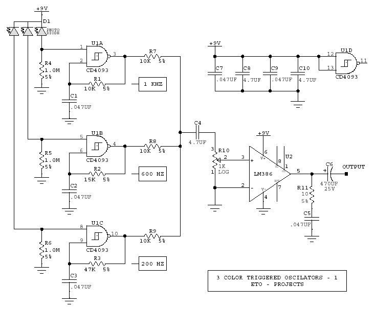

Here is a first pass at a corrected version of your schematic, plus a small audio amplifier, in only 2 chips. Note that this circuit may not work.
The CD4093 has the same schmitt trigger action as the 74AC14, plus each oscillator section has an enable input. Note that the 74AC14 is not rated for operation at 9 V, but the CD4093 is. IF (big if) the photodiodes are brightly illuminated, then they might pass enough current to change the enable pin state. I show 1 M resistors, but these might have to be increased for better sensitivity, or decreased if the inputs are too sensitive. If the oscillators never trigger, then you probably will need a photodiode amplifier circuit for each input.
The LM386 is a great little speaker amplifier for this kind of project.
C7-C10 are decoupling capacitors. Place one .047 and 1 4.7 cap near the power and ground pins of each chip. Keep the wire lengths as short as possible.
