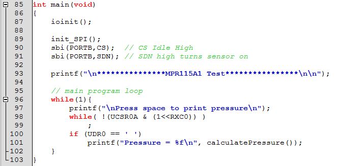

Code Styling Guide for embedded systems
Sorry, I started it, however, so much bad code above, I need to go sleep. My example was to try and show how not to write code!! Again, sorry. So much unreadable code, I'm sure it will be unratherable in the morning. Goodnight.
I know its just me but I cant read the indentations well like that, I have to have them inline or I cant tell which is grouped with which. Also since I didnt learn the capital and lower case thing for variables when I started I now find it hard to stick to that, one reason something like this is essential for people learning to program.
Inspired by this topic I wrote a post in the Code Repository. I think it represents the style I like.. style and structure.
I write this kind of small test projects for individual modules. Small project gives more motivation to clean up the code. After testing and cleaning the module is ready to be used in a bigger project.

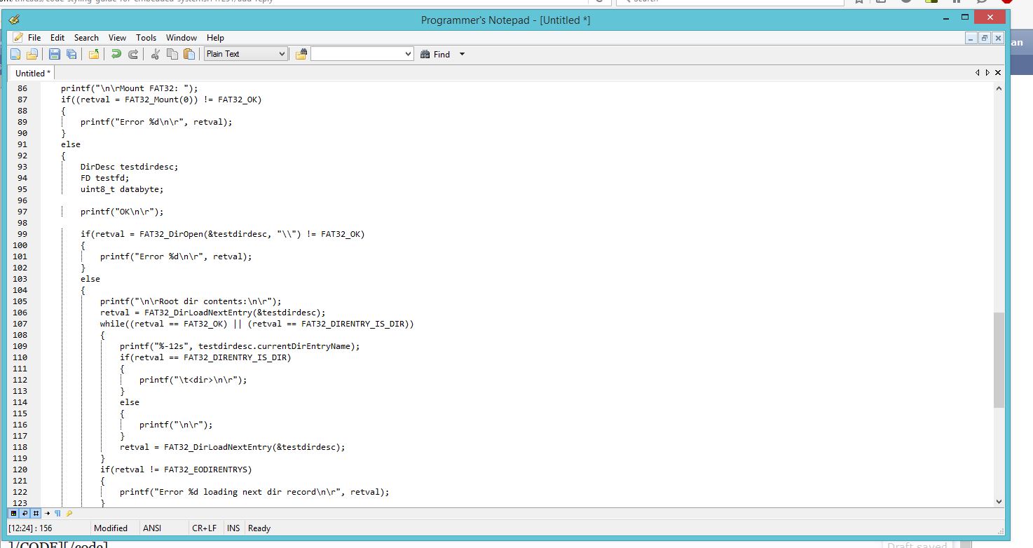

I am still doing something wrong

Thats odd it dosnt post well straight from github you have to paste into Prog notepad first,also its stripped out the formatting

it should have formatted like this
What do you mean by Prog notepad? Windows Notepad program?
It looks as if the original github was in Unix or Mac text file format. The biggest difference is in their method of ending lines. Windows uses a CRLF (carriage return and line feed) pair, while Unix terminates a line with just an LF character. Notepad doesn't convert cleanly; Textpad and Notepad++ have an option to specify the file format when saving. It appears that the text editor you used cleaned up "white space" and thus you lost your formatting. I don't have that problem with Textpad, but have experinced it elsewhere. I use the Arduino IDE almost exclusively and it has a built in tool to format/indent the code in a clean manner. You could post-process your file in an IDE to rebuild the formatting.
I use programmers notepad 2. I will look into the line ending thanks.
Actually if you look at the pic LF+CF are on so the formatting should have been as in the pic
Have a look at Crimson editor, free and formats the code real sweet, kinda like what my wife says I am, sweet:)
