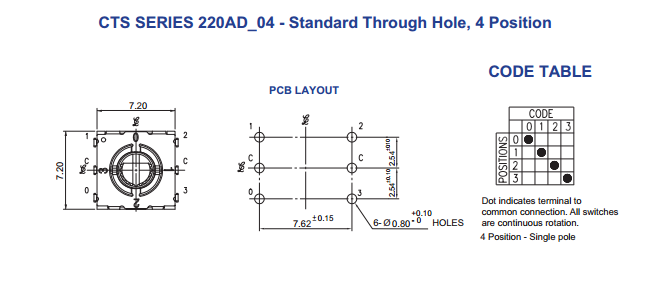

In the case under discussion, I would not have followed the approach MrDEB took. If we believe what he's saying, he's using a SP4T switch, requiring 4 port pins to read. We don't know for a fact which switch he used, as the data sheet he linked to includes switches of a number of configurations.
What I would have done is to use either a 4-bit encoded rotary switch or a 10 position BCD (binary codes decimal) switch - I would suspect these are the more common type in this form factor and may indeed be what MrDEB has installed on his board. If this is the case, 4 port pins would provide either 16 or 10 values. In this case, the 4 port pins should be read as a group and decided to 16 (or 10) values. The same amount of hardware would provide 16 options instead of 4.

Based on the discussion and the drawing in post #6, it seems we're using this switch and it's wired for active low signals on the A4..A1 inputs. Correct?
Please tell me if I have this right, guys? If you sample the active low switches on PORTA bits b4 through b1 you would get one of the following values (ignore unused bits);

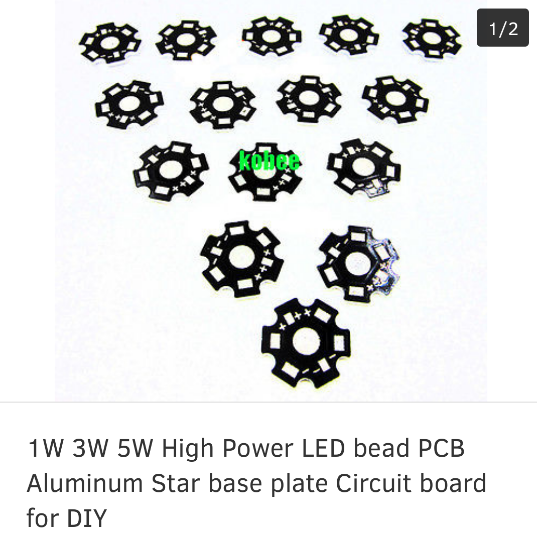

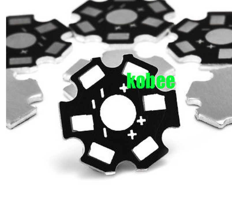

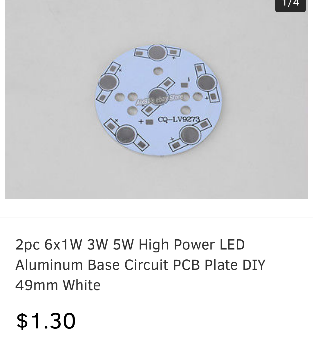

Here's a random thought for MrDEB's project before he converts too many LEDs to hazardous waste.
Aluminum circuit boards are available on eBay for mounting LEDs. Single LEDs are typically mounted on these "star" boards. Note that these circuit boards help with heat removal but won't provide enough heatsinking by themselves, particularity with 3 watt LEDs.
You might get away with a larger board designed for more LEDs without additional heatsinking.
I mentioned the Aluminium circuit boards and M Smith connected 4 of the 3w leds in series and said that they don't get hot??
My suggestion was to put 5 leds in series so no resistor is needed.The 140 wire wound resistors, at $1.20 each aprox depending on quanity was really not needed as this is only a 15 minute display for 5-7 times come September. Remember this is a non profit set up for a school and he is footing the bill upwards of $1000. All 10 boards are assembled and ready for shipment after I get the .1uf smd resistors.
As for the switch, I posted a link to the 4 position rotary switch. After I inserted SETALLDIGITAL into the code the circuit works just fine.
Thanks for the nudge to solution. https://www.mouser.com/ds/2/96/220-786387.pdf
It is the 4 position single pole switch that I have the all 4 terminals excluding the ground common, tied high via 4-10k resistors.
