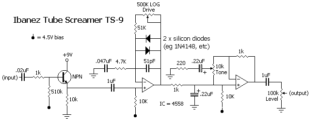

Now, could u please explain what happens in case of the -ve feedback loop in an op-amp? I'm attaching a circuit schematic of the Ibanez Tube Screamer TS-9 as an example.

The output of the 1st opamp will be limited to a positive-going and negative-going peak voltage that is the forward voltage drop of the diode, plus the peak level of the input signal.

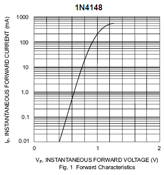

The diodes don't abruptly start conducting when the voltage across them is 0.7V. In this circuit, if the "drive" pot is max, then the diodes begin conducting when the voltage across them exceeds slightly less than 0.4V.

In the -ve feedback loop case, when the diodes r clipping, how do they affect the fuzz/buzz or whatever coming thru the output, since imho(which can be more wrong than right) it is putting the clipped signal int the inverting input, which i think acts as a gain regulator?
When a diode starts conducting then it shorts the negative feedback resistors, severely reducing the gain of the opamp so it acts like a follower.
When the fuzz circuit is working, its output is square waves since the peaks of the music are chopped off.
When the diodes r working in the feedback loop, they r sending the peaks of the signal into the non-inverting input and letting the signal chopped signal to go thru the output - am i right? And is there any reason 4 making it act as a voltage follower?

When the diodes are working in the feedback loop, they are sending the peaks of the signal into the non-inverting input and letting the chopped signal to go thru the output - am i right?
Correct, but the chopped output level would be modulated by the input signal level. Opamps always try to keep their inputs the same.

Then if the input signal is high enough, the output has some of the dynamics of the input. It is called "soft clipping".
An inverting opamp signal chopper or a resistor feeding a couple of back-to-back diodes to ground would just have ordinary fixed-level square waves at their output.

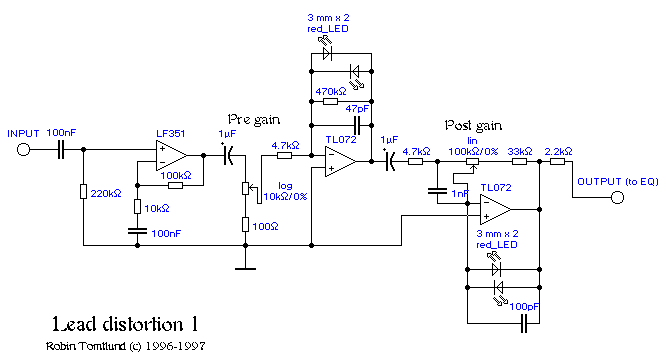

OK. I get it. So r u talking about something like this?(See attachment). So how is inverting op-amp increasing lipping?

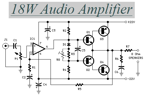

btw, a dumb question: If op-amps have huge gain, why don't ppl use op-amps 2 make hi-fi amplifiers?
They do, almost all transistor HiFi amps are opamps, some even use opamp IC's for low level stages, but the power amplifier itself is almost always a high power discrete opamp (or a high power IC opamp, often a hybrid circuit).
Don't try connecting a speaker striaght to any old op-amp and set the gain up high though, power amps need to be able to supply far more current than an ordinary op-amp, a 741 or 071 will probably melt if connected to an 8ohm load.
That gain can be useful though, to amplify the tiny levels from a microphone into a more useful level, however, you'll need a very low noise op-amp to do that well.

(See attachment). So how is inverting op-amp increasing clipping?
The diodes across the opamp's negative feedback resistor cause severe hard clipping when the output level of the opamp reaches the conduction voltage of each diode. With a higher input level then the output is square waves with the amplitude of the forward voltage of the diodes.
They do, but since most opamps have an absolute max supply voltage of only 36V, the amp's output is only 16W into 8 ohms. Two of these amps could be bridged to provide about 56W into 8 ohms.
Only one opamp that I know has an absolute max supply voltage of 90V. The OPA445AP could be used to make an amplifier with an output of 100W into 8 ohms. Two of these amps could be bridged to provide about 360W into 8 ohms.

You've not made it very clear Audioguru! - simple opamps WON'T provide 360W, 100W, or even 16W. They only provide very small output power, and generally only into fairly high impedances.
But you could use them, along with suitable output stages, to make high power amplifiers - but it doesn't really simplify things much, so it's not particularly common.

Of course I was assuming that the wimpy opamp would drive a high-current complimentary power darlington transistors output stage, like this simple one that uses a 44V-rated opamp. Don't ever short its output or you'll be blinded by the smoke:
