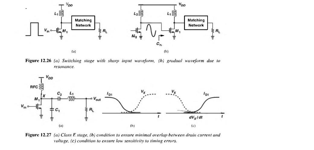

Please help me with these questions about class E power amplifier. Thanks.
