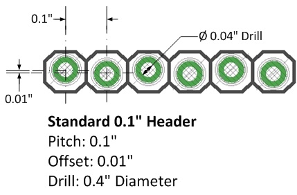

JonSea, where could I find that footprint for the staggered pin headers? That seems quite handy for larger batches.
you might find them at sparkfun.com. Look for a eagle library. OR Modify an existing part, change the name and offset the location on some of the pins.
I have a drawing for 0.1" pitch square pin headers. I'll post it after I get home. The holes are the usual size, just offset from the base line. Depending on the plating thickness of the holes, it works anywhere from "good enough to hold the connector perpendicular to the board" to finding I forgot to even solder a header until it came free from the board when I tried pulling off the connector.
Here is the Sparkfun's "lock" pattern for square headers. The offset between adjacent holes is 0.01" – I usually make one hole 0.005" above the centerline and the next 0.005" below the centerline so there's no offset of the header center.
Oops, in the note below the illustration, it should be: Drill: 0.04" diameter.

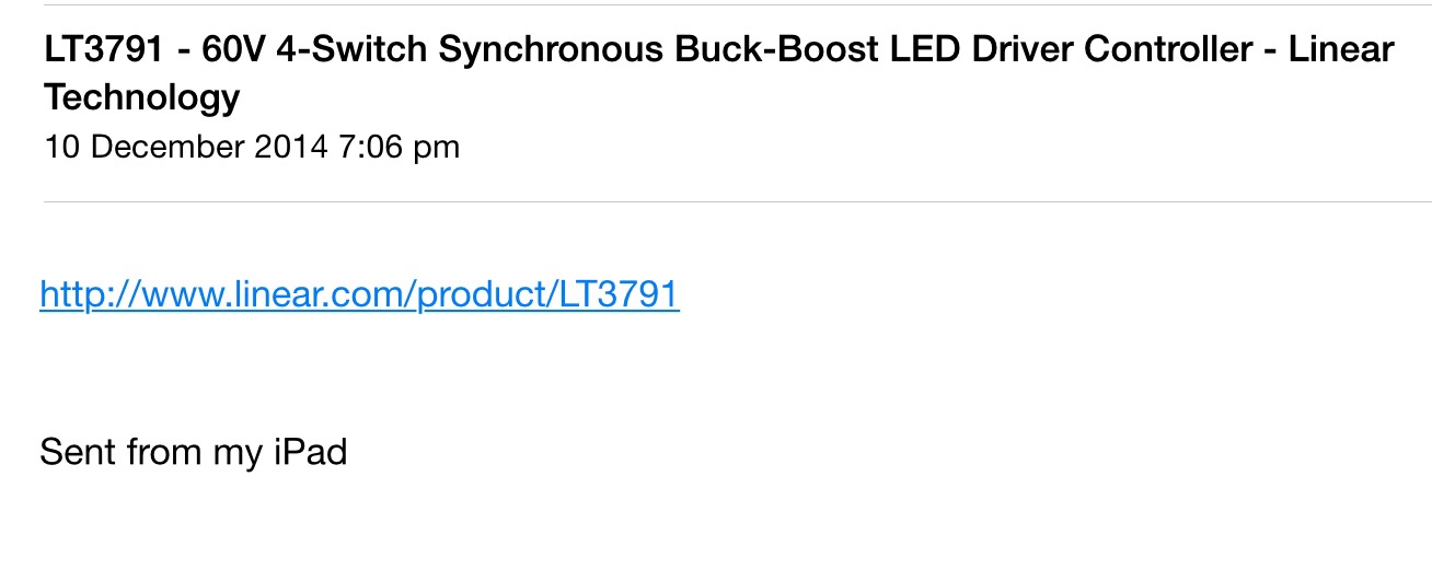

This is the circuit that I am describing but am not sure weather it will do the job . If some won could advise me. The circuit I require is one that will drive a led light and can be dimmed .
Led is max 36 volts @ 9 amps The power supply is battery.

That is not a circuit, try again.
If you type into Google
Liner LT379 this is the circuit that I have tried to draw on cad but no luck .
I had given up but received this post and it has inspired me again as I need help with this project.
Thank you Greg for getting back into this project .
Hope you can help me out.
