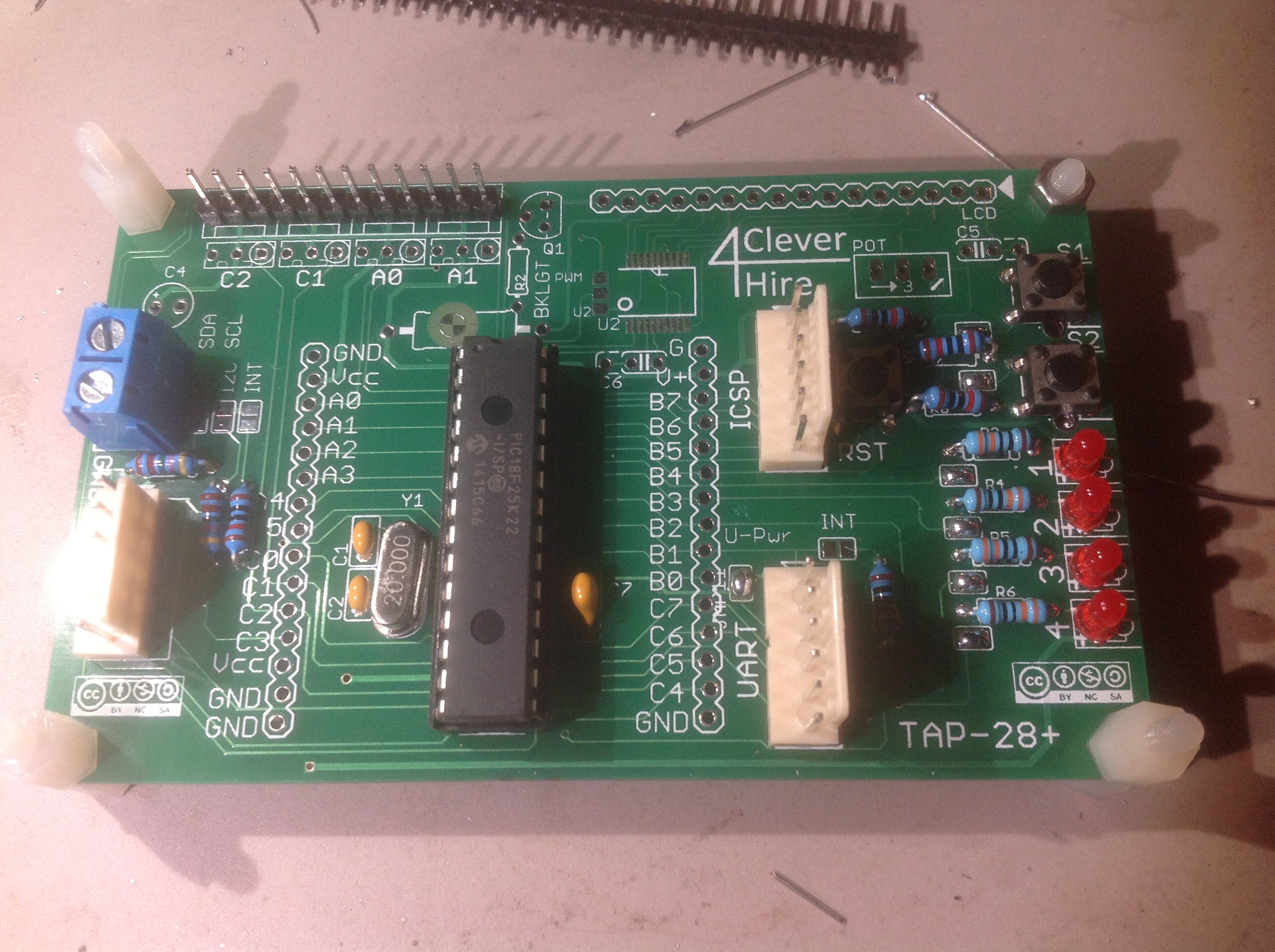

Here's an example of a board that was $15 for 10 copies from Elecrow.

By the way, in the picture above, the holes for the header aren't in a straight line. This is by design – it's Sparkfun's "lock" pattern. The slight offsetting of the holes helps hold the header perpendicular to the board for soldering.

What you making there JonSea?
The picture I posted is an application board for 28 pin PIC18F-series chips. It's got a few LEDs and switches and connectors for I2C/SPI, UART, a couple ADC pins and a couple PWM pins. I call these Throw Away PIC" boards because they're cheap enough that you can dedicate one to a project and not worry much about the cost.
This one is a new design, with an I2C-driven interface to a character LCD. This board is the same size as 4x20 displays and will piggyback with them.
I developed the first "TAP-28" board several years ago, when the things Cicero said were true. Back then, the best deal I could find was about $75 for 3 boards. The only way to get cheaper boards was to make lots of them. I designed a board that was useful as a building block for most of my applications, had a hundred made and offered them at reasonable cost to members of the programming community. By sharing the boards, I got cheap boards, other people got reasonably-priced boards, and I made about enough to have a cheeseburger on the way to the post office to ship boards when somebody bought some. The second batch I had made was 250 boards and after a few years, those are about gone.
These days, it doesn't make much sense to do this. Anybody can order ten boards for around 20 bucks. There's no need to order a hundred or two hundred boards to get the price down.
There more information about the original TAP28 board here.
