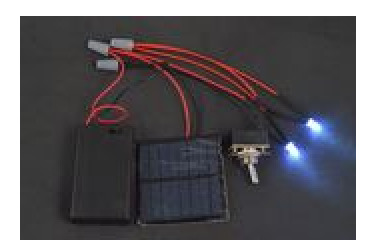

How much are you willing to spend?
Reason I ask is that **broken link removed** is probably the cheapest you'll find with all the parts needed to make what you have described. And no soldering necessary, just "wire nut" it all together: Its $19.95 plus shipping. I don't think you could buy the individual parts needed for that amount of money...

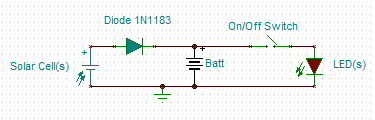

I can work up a schematic for this circuit, if you like.
This looks perfect!
However, is it possible to get a bigger bulb as I'm making something which will need more than just those little LEDs. (Of course I'll buy them additionally to the kit)
You can use as bright or as many LEDs as you like, if connected appropriately.
However you must have a large enough solar panel to recharge the battery in whatever time is allowed in sunlight, to make up for the total power used by the lamp(s) in whatever time they are switched on.
If you want to power a large lamp for long periods, you need a big! solar panel, plus a battery big enough to run the lamp for as long as needed between having sunlight to recharge it.
Note that for any significant power use, the solar panels must be in direct sunlight to provide practical levels of power for battery charging; the energy from direct sunlight is around 1000 Watts per square metre, so even though solar cells are not very efficient, you can get a decent amount of power from them under those conditions.
In artificial light, the power output is trivial - eg. in a typical room, the electric lights may give about 10 - 20W total light output, over the entire area of the room. The solar panel gets a tiny amount of that and converts a few percent of what it does get to electricity; small fractions of a watt.

Also, would it be possible for someone to create a basic circuit diagram for the kit above?

Also, would it be possible for someone to create a basic circuit diagram for the kit above? ...
118756
The ground symbol (
118759
) is only shown because the simulation software (TI TINA) requires it.
LEDs run at somewhere between 1.8V - 3.5V typically; Red are the lowest, then yellow - green - blue/white.
The LED efficiency and current determine the brightness. Typical older or panel indicator LEDs are just a visible light point at 20mA, some newer ultra-bright white ones are literally painful to look at, at the same current.
That "kit" circuit needs a diode (preferably a schottky rectifier) adding between the solar panel and the battery, or the battery will discharge through the cells when there is no light.
