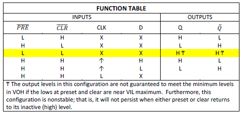

Well I reported a 'bug' with the D-flop model to LT and was politely told it wasn't a bug as far as they were concerned. So it wasn't resolved to my satisfaction :D. [Run a sim involving a D-flop (eg the basic flop or a CD4013) with both R and S high. According to datasheets both Q and not-Q should go high].
According to datasheets both Q and not-Q should go high.
Just so I am clear, attached is a clean copy of what I've seen in the TI datasheet covering the SN7474, SN74LS74A, and the SN74S74. You are talking about the conditions where both outputs are high ... which is not guaranteed by the manufacturer.

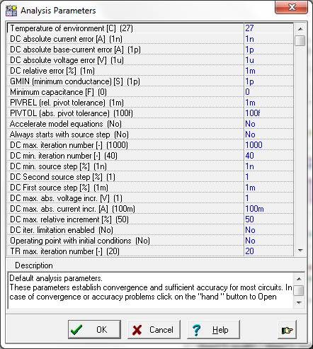

The parameter names are covered in the pSpice f3 manual. Any program or model claiming to be compatible with pSpice should already be using those parameters. The options list could be quite extensive and some programs already contain easy access with a single click some graphing options. Others require you to pick the variables you want to manipulate for the graph. Some provide capabilities for both. Some allow you to customize the simulation parameters as well as the model parameters. Attached is a partial listing of the parameters I can change.
