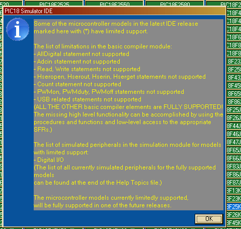

I think Oshonsoft ignores the 'L', for programming.

Check thru this OS list first.

Thanks, what a shame!
As a limited programmer, I guess that I should stick to the ones above the ********************* set of PICs.
If I recall correctly you wrote a section of code that got round the PWM limitations of the PIC I was using at the time, which is one of the items on the un-supported list. I doubt you would wish to do this for all of the other items :arghh:

Slightly 'better' is 18LF26K22. These latter PIC's aren't shown in the Oshonsoft list, but would they program ok? The L is for lower voltage and I think the K shows more timers. The 40 pin type are not quite right as they don't have the SOIC footprint, they are smaller (Beyond my circuit making skills)

The 18LF26K22 is listed on OS but it has the limitations I posted.

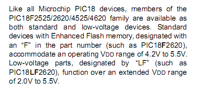

The LF has a wider operating voltage
E
