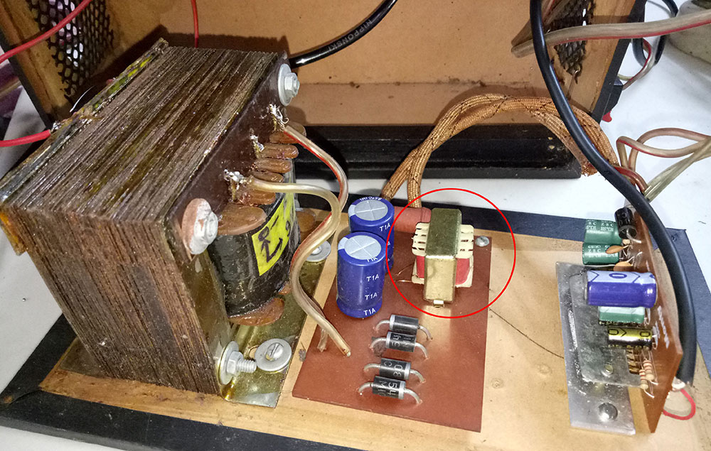

Please tell me the substitute of the choke coil which is available and compatible with any audio amplifier in India. This choke coil is for an audio amplifier. Please read the red circle mark also.

That choke coil is part of the DC power supply. Looks to be ~0.5H, rated for ~3A of DC current.
It's also a component that's not been used for MANY decades, and hardly ever in transistorised amplifiers.
They were used in valve amplifiers because of the non-availability of large capacitance electrolytics - it was never a problem with transistor amps, as the much lower HT voltages meant that suitably large electrolytics were easily available (and reasonably sized as well).

Simply increase (substantially) the value of the reservoir capacitor, like I said before chokes haven't been used in that way for many decades.

I don't know what you are doing, and neither do you. But the cheapest and easiest thing to do is get a normal 240v: to 15v or 30v power transformer and use just the secondary. Compare the ripple and let me know. In other words, listen to the hum.
Compare the output voltages too.
Right now, I have to discard my power supply module for DC filtration and stick to the capacitor for filtration purpose. Always my required voltage is 12 for my LA4440 audio amplifier and 5v is for Bluetooth mp3 FM module as well.
