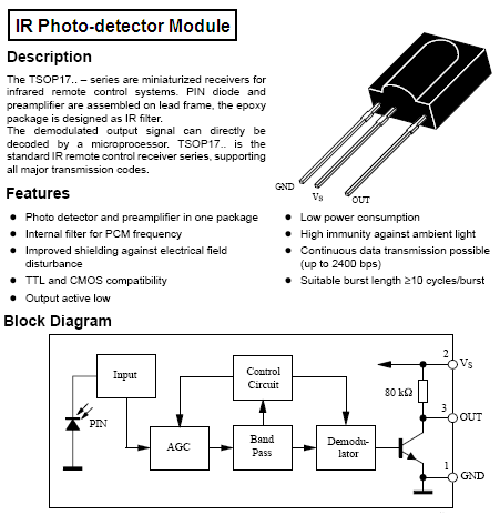

i'll use a photodiode to acquire signals from a modulated infrared LED, and then using a bandpass filter to get the main frequency (fundamental).
would you have some tip?
Use an IR receiver IC that has a visible light filter, a photo-diode, a high gain amplifier with AGC, a bandpass filter and a demodulator.

Audioguru's tip is very good.
I'd prefer to use a phototransistor, since it's pulsed.
But if you really want to use a photodiode, it's better to "buffer" it.
Use a FET input OPAMP, like TL082 or TL072, to build the buffer circuit. Since we can consider a photodiode as a very high impedance source, if you use a BJT input opamp, the voltage will be (not always) unpredictable (it will be more difficult to find "trigger voltage" for the opamp).
Then do as Audioguru says. Don't forget the visible light masked photodiode, it's very important.
IR receiver ICs work at frequencies of 30kHz and higher, not as low as 10kHz.
Yes.
Some days ago I was trying to use a IR receiver set, from a Sharp VCR, it was not working... Then, I looked into a datashee... There was a high-pass filter there.
