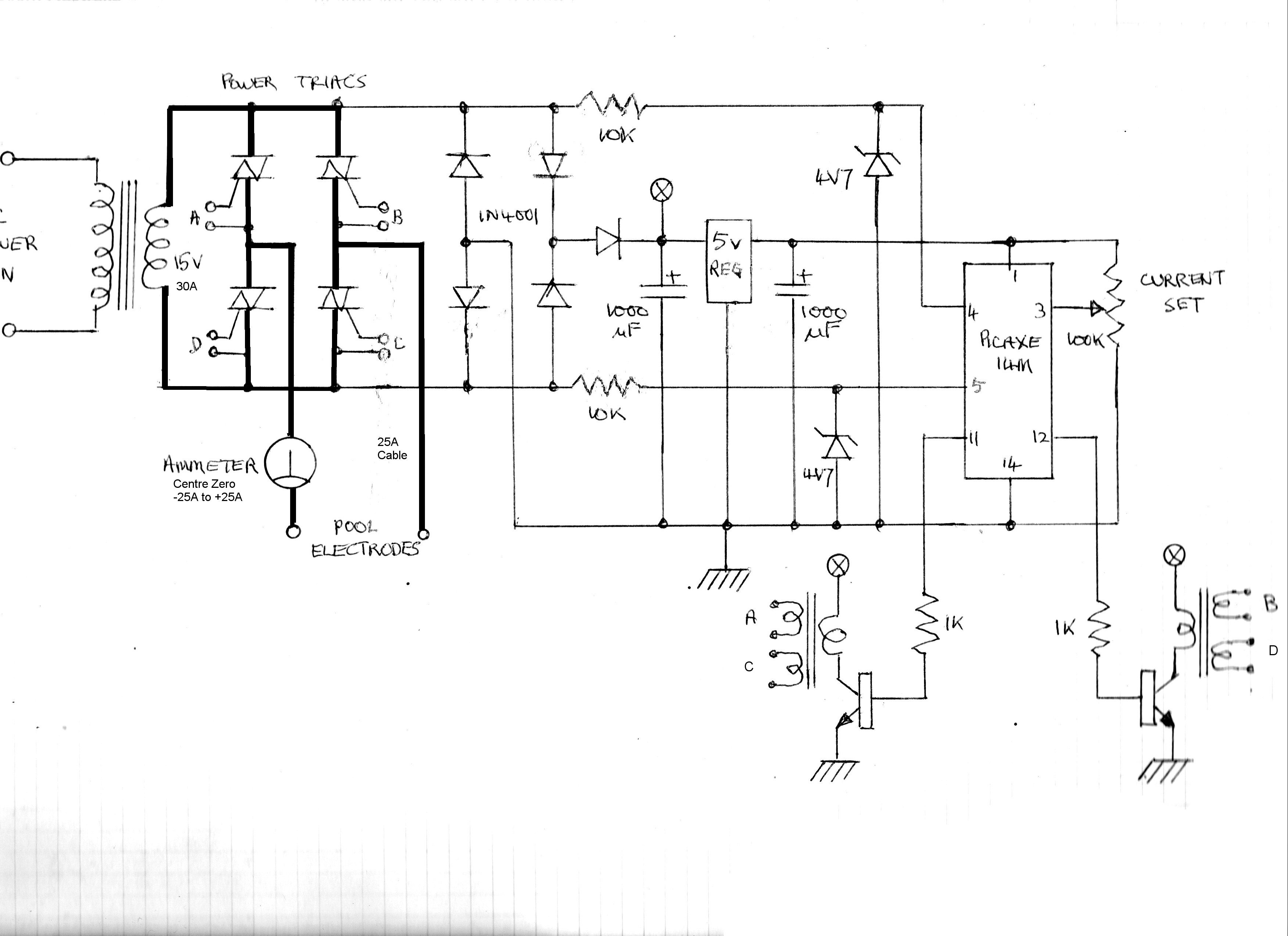

The circuit diagram for a Chlorinator and the software to run it is attached.
  • Chlorinator1.txt
  • ChlorinatorDescriptiont.txt
Bruwer
I will have a look more closely later but it seems you you powering the electrodes with AC. Typically at 50-60Hz.
I can't see how that works as it would not allow sufficient time for the cell to discharge before reversing. I've never seen a cell powered by AC before. I assume for this reason.
