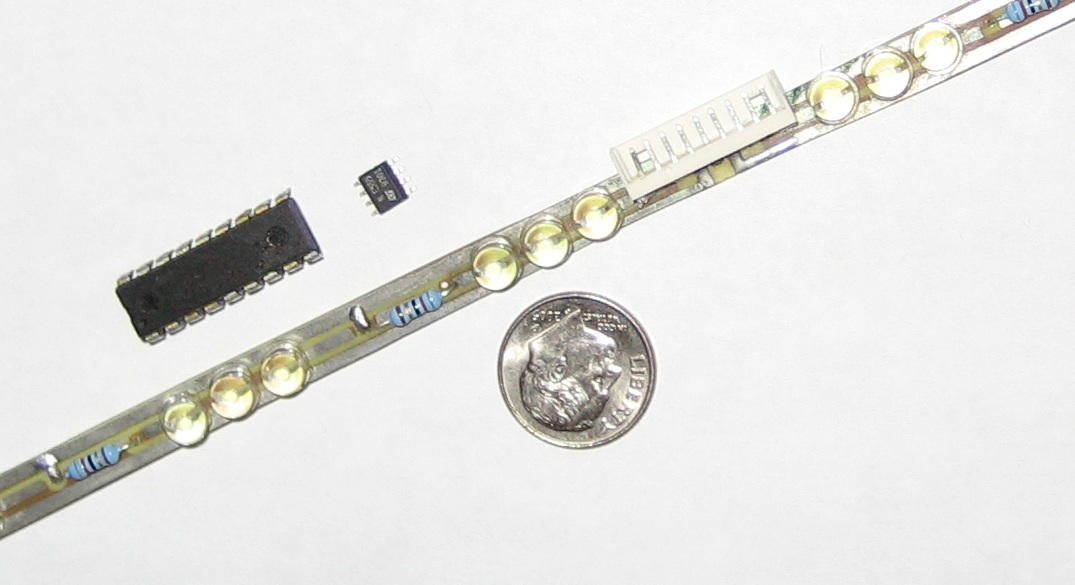

First Prototype Pictures...Board 0.25x13. An 8 channels (8 Cathods, 1 Anode) 12V per channel, 20,000mcd per LED (60,000mcd per channel)
Pictures show the board next to 555 timer chip in a SO package, an 18 DIL PIC, and a US-dime for size reference.

Maybe in that form factor you coul dput a PIC or other micro on board, and then you only need 2 power wires and one communications wire to control them?
Point well taken. However placing any chip (PIC, LED-Driver, Register) will limit both current and voltage supply to each channel. In the prototype configuration current per channel is about 30mA per these LED specs, however voltage per set of 3 LED+resistor is 12v. With added on-board chip then additional transistors (N-MOS) is required to handle 12V. On a 0.25" wide board as you can see PCB real estate is tight.
Also adding a chip (PIC specifically) will limit the affects only to this board. With the prototype board I am using 8 cathod and one positive feed. You can run 8 wires (CAT5) parallel from LED board to LED board and the positive feeds can be multiplexed. Example using PIC16F628A: 8 wires from PortB as your sink lines (Thru LED Driver Chip) common to all boards, and use 6 lines from PortA to drive 6 different boards(LED Driver or NMOS). Multiplexing 8x6, 48 channels on 6 boards. The 8-bit-base configuration will also allow the controller board to PWM, hand shake with 8-bit registers, and so on.
The 6 drive channels can also be expanded to 12 (50% duty), 18 (33% duty), 24 (25% duty) and so on driving additional boards. (expanding thru time sharing)
I still like your original idea of an on-board latch register. I am going to toy around with that a bit more since it allows for expansion from board to board.
