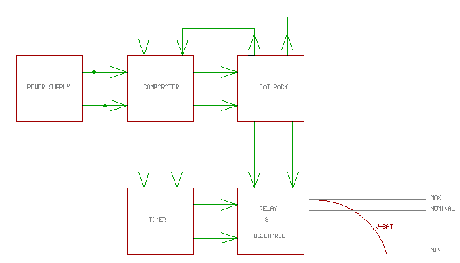

Here is a rule of thumb to charge NiCads:
Charge at a constant current of 1/10C. The charger circuit voltage is unimportant during charging time, but should be well above the final desired charge voltage.
A 5 cell NiCad can be charged to 8.0V (1.6V/cell) without any problem - no matter which brand you use.
If you can make it use a charger which disconnects charging voltage at regular intervals and discharge the battery via an electrolytic capacitor, with the battery connected to a comparator circuit which will decide to continue charging or leave the battery pack alone.
Something like this.
Boncuk
