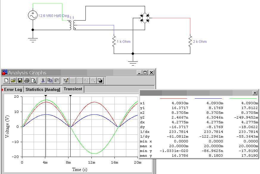

Here's a neat and simple connection that does what you want with full-wave rectification for both voltages with one bridge.
Connect a full-wave bridge circuit between the two 6.3V windings. Ground the negative node of the bridge. You will now get a full-wave rectified +12.6V from the bridge. Nothing unusual there.
But what's interesting is that there will also appear a full-wave rectified +6.3V at the center-tap of the transformer. The reason is that the two diodes going to ground in the bridge act as a 2-diode full-wave center tap rectifier. It appears a little odd since the rectifiers are in the ground leg instead of in the hot leg as normally seen, but it works just the same.
So with the addition of just two diodes you go from two half-wave rectified voltages to two full-wave rectified voltages.
One consideration is that the two bridge rectifier diodes going to ground will have to carry the total current drawn from both voltages.
Edit: Below is a simulation of the circuit.

So what are you proposing, rectifiying each of the 6.3VAC taps and "stacking" the bridge rectifiers by connecting V- of the top one to V+ of the bottom. Sort of a center-tap fulll wave rectifier? I've never tried that. FYI, the transformer is only 1A and I don't expect to need more than 1/2 that (or 1/2A).
So what are you proposing, rectifiying each of the 6.3VAC taps and "stacking" the bridge rectifiers by connecting V- of the top one to V+ of the bottom. Sort of a center-tap full wave rectifier? I've never tried that....
Sort of. But it's all done with one bridge. See my edited post circuit simulation.

The peak output of a 12.6V AC RMS waveform is 17.7V not including diode drop. Or are you including the normal overvoltage that most power transformers exhibit under no load?
The scheme I proposed generates both voltages which minimizes power dissipation in the linear regulators. It also causes no net DC current from the transformer.
