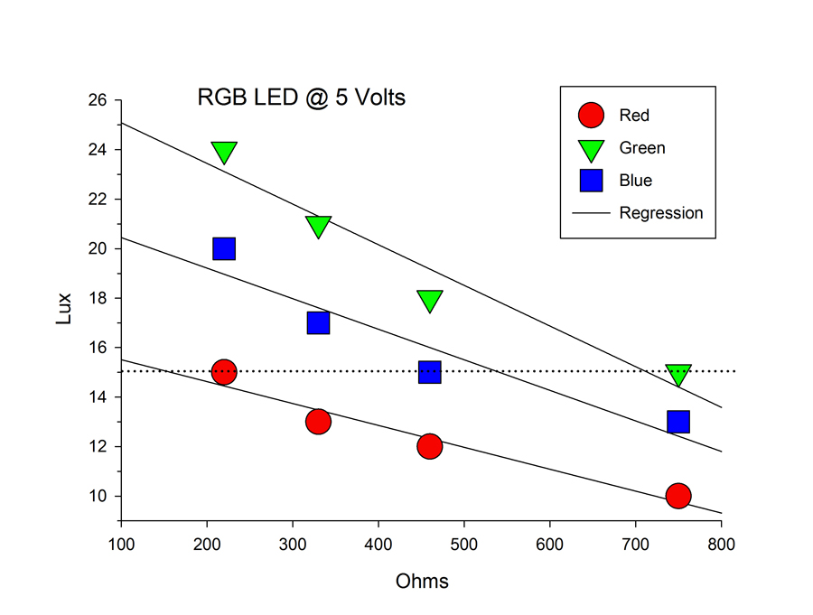

About 5 years ago, I used one to figure out the resistors to use (to aim for equal intensity) on an RGB led for a color mixer using a pic 12F1572. Was not smart enough to do it with math so I did it like this:
I used the values shown on the dashed horizontal for the respective R-G-B elements. Empirically, it worked and I was real proud of myself. After about 10 minutes of staring, I started to see spots and was less proud :)
