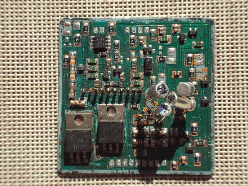

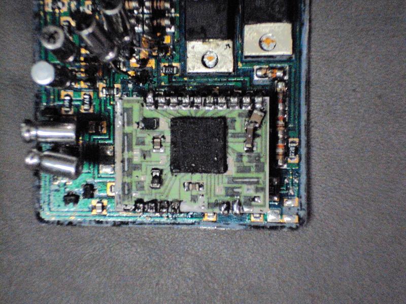

Just curious Is the internals of the module acessable? What is the fault with the unit? not working at all or only 2 cylinders firing? It may just be possible to repair the module. I would suspect the most likely components to fail are the SCRs which fire the coil, or the HV inverter. A good clear photo of both sides of the module board would be a help.
The module was encase in rubber compound so i had to use acetone and leave it over night. It did desolve the rubber but it also desolve some of the components i kinda over did it. I was trying to recreate the circuit and build my own, but some components had no info on them because their too small. Also my solder iron was way too big. I decided to try another route and build from scratch. I cut the top level off the circuit board to get a look below, i think i screw that board up...lol

I don't think this is a CDI ign at all, more like a transistor switching Ign system. The timing would be adjusted with that processor. My approach to exposing components is carfully diging not dissolve the poting compound. Ive had to work on a mates Kawasaki KZ1000 with a faulty Main & Pump relay module as they were no longer available. .

I didn't get a chance to post the schematic but will later today. I think the unit is described as a IC Igniter component. I checked the 10-pin connection for internal resistance check against the manual and found pins 1-3 not within spec, but not sure if that’s my meter not reading right or the IC Igniter is somewhat bad.

I noticed 2 transistors on the board D1071 these are NPN darlington transistors 450V @ 6Amp switching. These are most likely the Ign coil switching, check these are ok. Also these bikes if dropped on there right side can damage the bottom pickup coil & cause intermittent spark problems.
I previously did check the pickup coils and test within spec against the owner’s manual. Yes they are D1071 transistors; I’m not able to test them while installed so getting them out is very difficult because there surface mount type. These transistors don’t have a cross-reference that matches but some are close. Right now I’m working through my coils, spark plugs, and wiring to see if any of those may also have problems. This bike road straight for 2 years every workday rain or shine, 2-hour round trip from work. I’m not sure if it’s a quensident but it started just when it was getting hot here in AZ.
2SD1071 transistors are available on ebay quite cheaply. Have seen quite a few pickup coils test fine with a multimeter, & still not work. Since there is 2 coils did the bike start running on only 2 cylinders or not run atall?
originally the bike started to run a bit rough so i decided to do the plugs, wire and card cleanout. after that it wouldn't start. I started toubleshooting and lead me to the IC Igniter. I put-out one from my other bike, smaller and different part number on the IC Igniter. It fire right up but would run rough after 4 to 5k rmp. I knew then it was most likely the IC Igniter.
