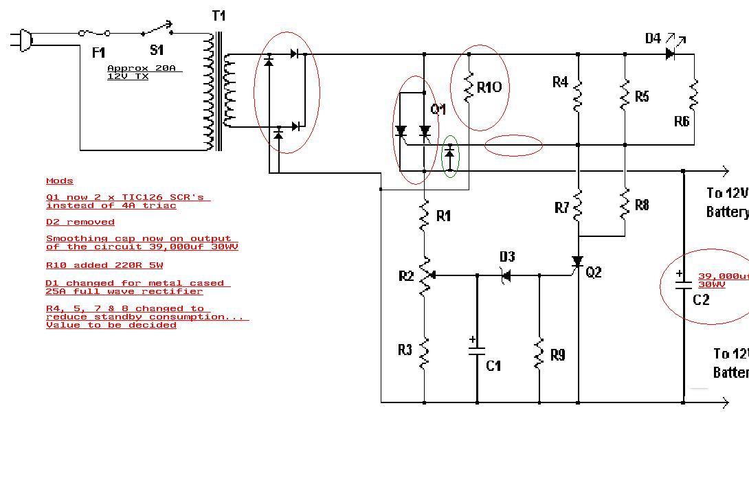

OK, thanks to all of you for the info, I've done a bit of looking around and found THIS circuit which is an automatic charger of the battery. Can anyone think of a reason why the charger may get confused and go into a cycle of "switching on/off" repeatedly because I intend to use it to power accessories up at the same time as charging the battery?

That circuit will decide on every AC cycle whether you need a boost. With your huge batteries, this cycle time can be several minutes, and could be hours. Since it's only designed for 4A, it still might not keep up with your load.
I would consider using a full wave rectifier in place of D1 to be nicer to the transformer. You might need a resistor across the unfiltered supply to help turn off the SCRs. I would try 200-270 ohms, 2W. It will get very warm.
I would be concerned that the BT136 is rated at just 4A and its actual current is limited only by the transformer resistance. The heatsink will need to keep Q1 tab below 100c which will be difficult in any enclosed space. I would normally use a 25A SCR or TRIAC in its place.
I don't understand why he used a TRIAC for Q1. If Q1 was an SCR then D2 would not be needed, and R4, 5, 7, 8 could be higher values for decreased standby consumption. (In this case I would add a reverse diode from the gate to cathode of Q1.)
I should have said earlier but I clean forgot to mention my intentions of 'upgrading' this supply so it will produce somewhere in the range of 20 - 30 amps. I intended on piggybacking 2 BT139 (16Amps each I believe) Triacs for Q1.
I have already made up a 12Volt full wave rectified & smoothed P.S.U. as mentioned above, so I planned to replace the existing transformer & D1 in this circuit with the ready made P.S.U. I now assume from your above info that the smoothing cap "39,000µf 30wv" will intefere with the operation of this circuit since it uses the 'unsmoothed DC' to decide when to go into 'Charge' mode. Will it work ok if I simply replace the transformer & D1 with my ready made P.S.U. but remove the smoothing caps and place them on the output of the final circuit?

So what you are saying is that if I replace the triac with a 2 or 3 SCR's piggybacked such as a TIC126 rated at 12A each then I could omit D2 and insert resistors such as 150Ω or are you thinking something higher like a 1k or more? Why may I ask would you use a diode from gate to cathode of the scr, I'm interested as to why you would add this.
I attach a modified diagram, can you please have a look and see if my mods are suitable, As for the diode you suggest from gate to cathode of the scr, can I ask your suggestion for a part number or type?
Another silly question I suppose but I might aswell ask it to go with the rest of them, Would a TIP126 or a C106D work fine for Q2 as a replacement for the listed BRX49?

New diagram is a very good start.
Correct you need to provide pulsed DC without smoothing. This supply is probably not suitable for use without a battery, it's pretty noisy.
I added the diode from gate to cathode because you don't want reverse voltage on the gate. (General Electric SCR manual, first edition, 1961, page 33). Looks a lot like a base-emitter junction, max -5 to -7 volts. Any 1N400x is good.
Unless very closely matched, thyristors are not happy in parallel. The hotter one would tend to conduct more current, which would make it still hotter. You can force current sharing with resistance or reactance (same manual, section 6.)
150 ohms for R4, 5, 7, and 8 sound good. Don't bother trying 1K, not enough trigger current.
The C106 is a lot more sensitive, but I don't see a problem with it in this case. NO on the TIP126, it's a PNP transistor.
I should remind you that the fuse is NOT optional. You may also need to include some means of inrush current limiting, because this design is not current limited at all.
