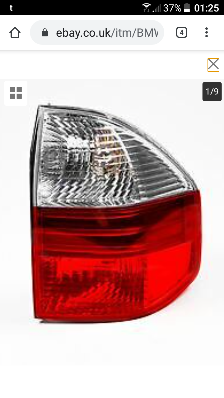

I have attached a picture of the actual lights to give an idea of what the board powers.
The three lines inside the light are like small tubes where the led sits at the end and illuminates them.
Just an FYI, in case you wish to know, or not...those tubes are known as 'light-pipes'.

As the LEDs are sending light to light pipes, the narrow viewing angle is probably what was designed.
