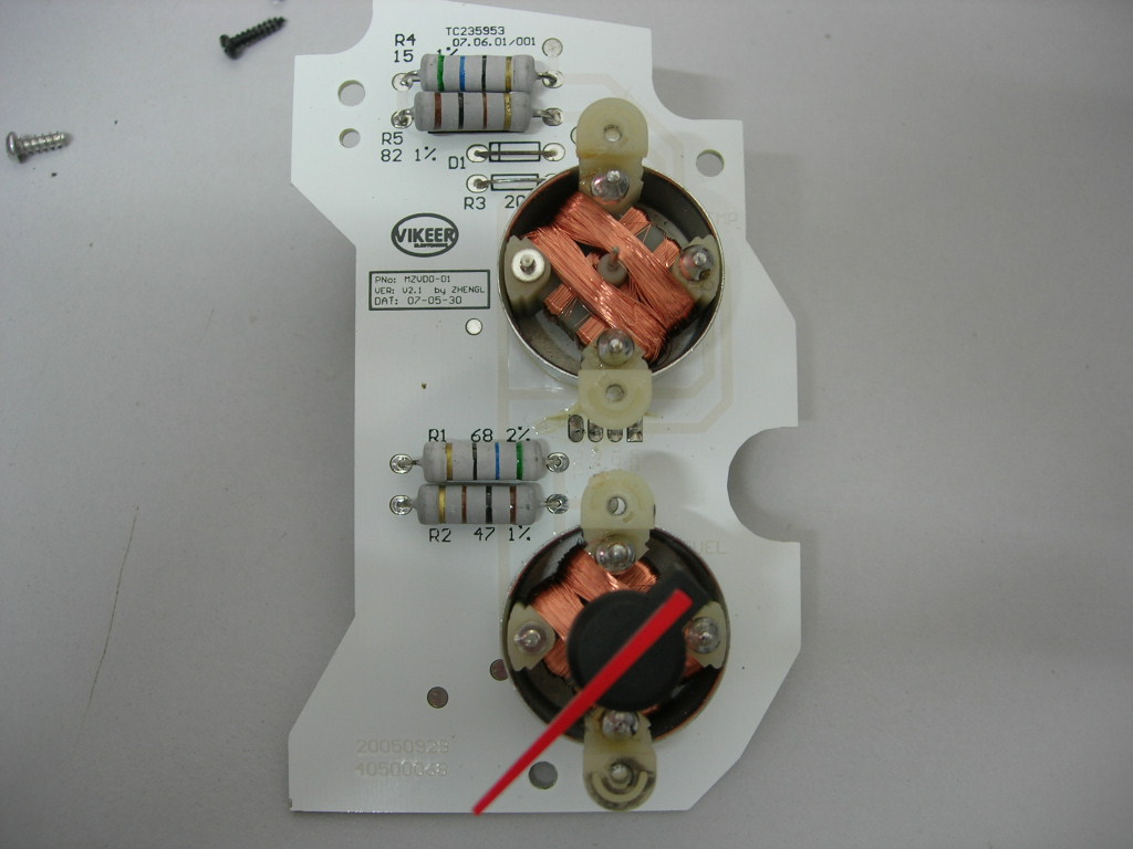

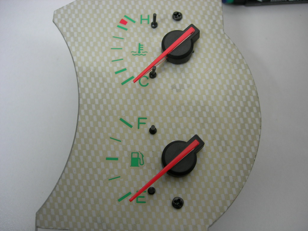

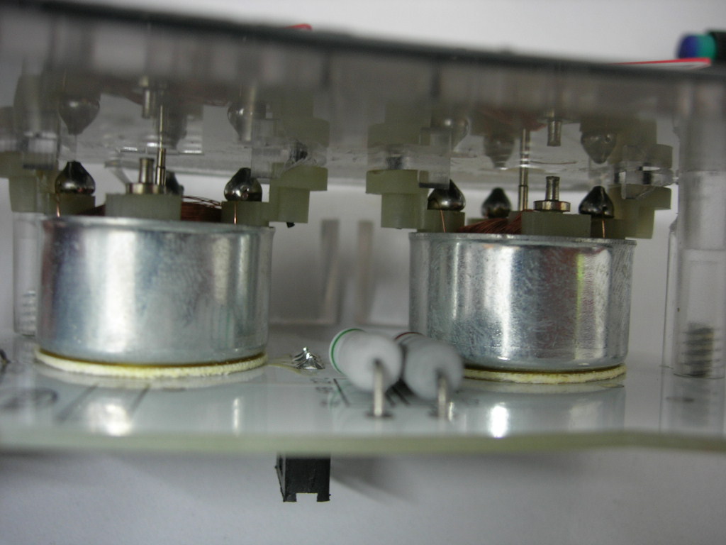

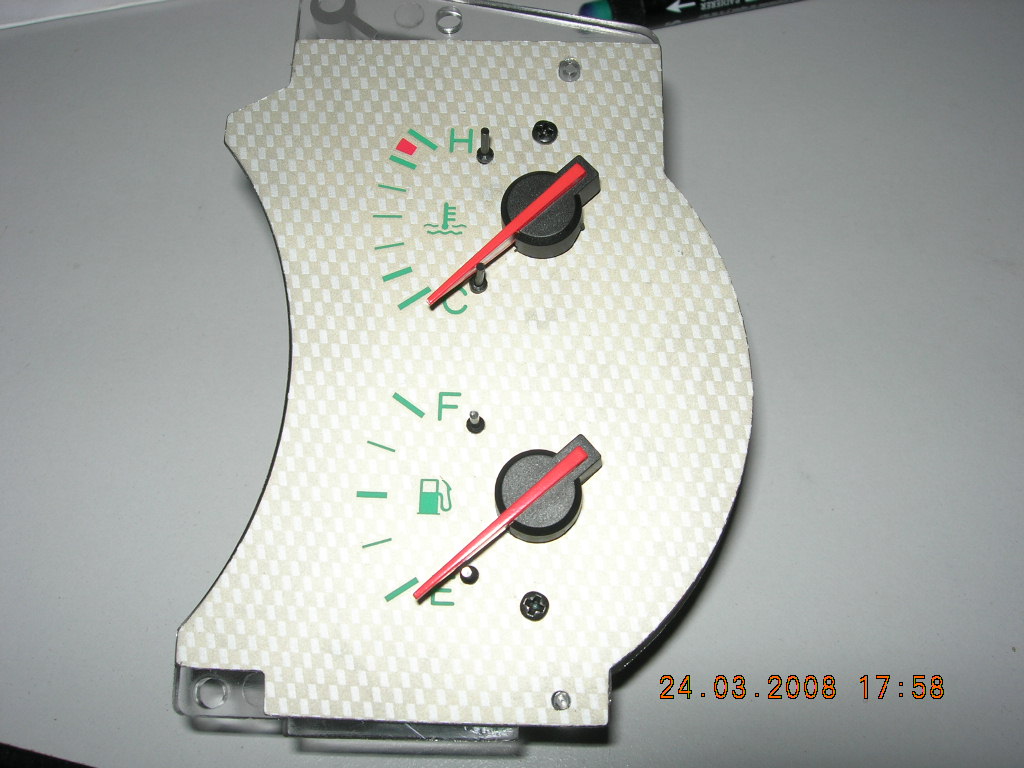

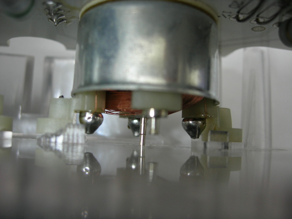

I try to understand how the meter in my car Dashboard Fuel and Temp guage,
open up, I see a meter with 3 input.
I have no idea what this kind of meter is, can anybody tell me what is it and how it work?

I still don't get it, an Analog meter (moving coil meter ) have 2 lead only, but this have 3 lead... and is it because of this, the pointer of meter will be very stable, not moving out much even a vibration shock during car drive, am I right? Where can I get more info about this kind of meter?
There are two meters on the panel, one for oil temperature and another for fuel level.
In my old truck there are two answers for why three “inputs”.
1. Some of the meters have three leads but only 2 are used.
2. Two of the meters have leads labeled “gnd”, “+” and “S”. The meter needs power and ground to work and one wire that goes to the sender. If you look at the Moving_coil_meter link they show a magnet. It could be made with a electro-magnet that requires power.

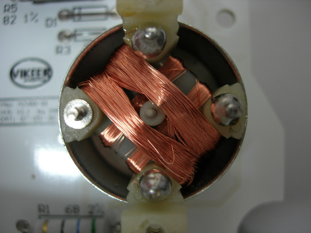

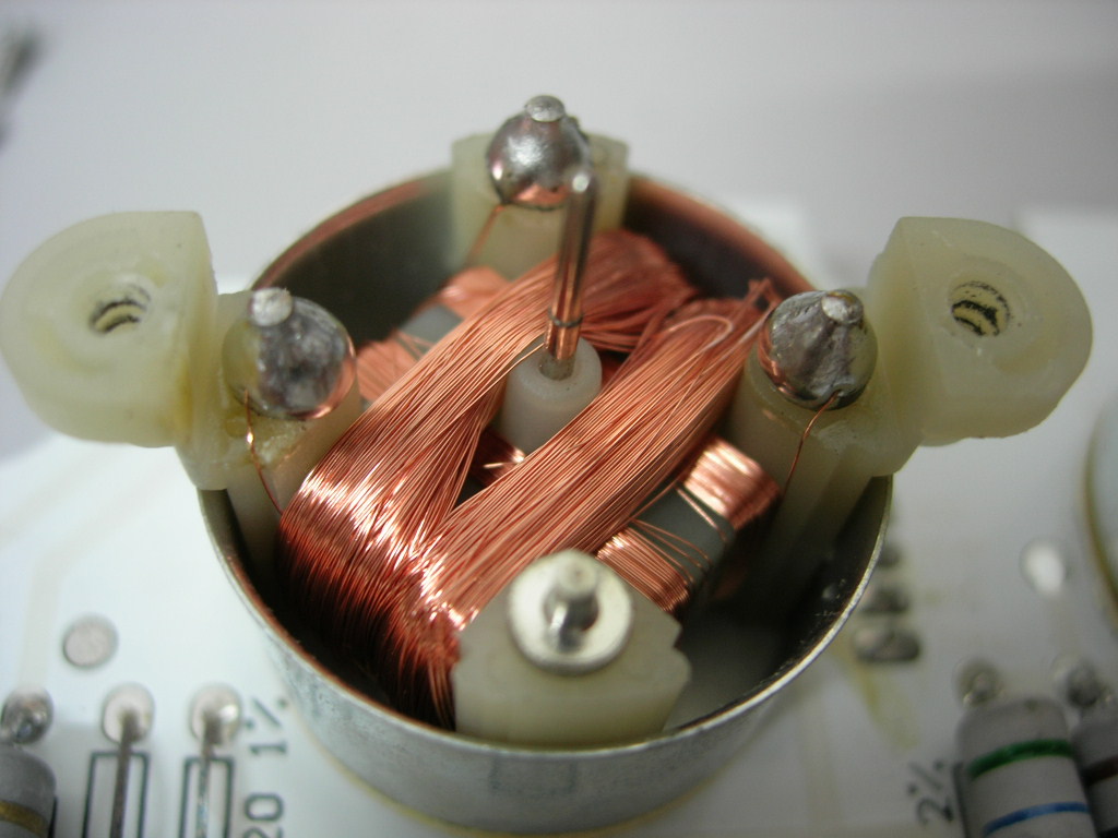

thanks for reply, I have open up the meter, I notice it is moving magnet, the coil with 3 lead is fix unmoveable.
And yes, there is (+) and (Gnd) connect to two lead of the coil through resistor.
But to control the meter, what shall I input to (S)? a resistor to ground or a small voltage input?

It's the same as the article on Wikipedia except that it uses another coil instead of a permanent magnet.
If each meter has three leads (which is what I think you're saying), then the third lead is for the outer stationary coil.
