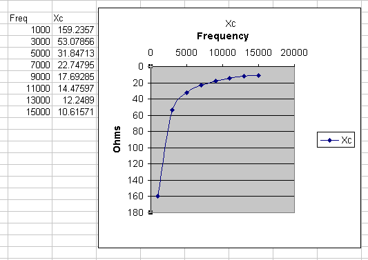

Lets face it. Were not trying to build the Hubble transceiver here. For general hobby use, one can take the fundamental frequency, plug it into the XC formula and make a good prediction of it's response for the waveform. Take my excel spreadsheet as an example. Using your values. A 1KHz sqr wave and a 1 uf cap. Consider cap in series, I can see from the graph that I have a high pass filter, and that the fundamental would be rolled off. I could tweak my C value higher to pass more of the fundamental. That is all I am saying. To ball park a series cap for example...
Hi again Mike,
Ok, no problem there, and dont forget i also said it's probably a good idea
that someone brought this stuff up.
The only problem i wanted to avoid is to give the impression that we
can use that formula with say a square wave and expect to get good
results for any application under the sun.
For example if we are working with a filter we might get
a ball park result, but if we are working with (a different example) say
the output from a square wave output inverter our circuit would be
constantly banged by steep wavefronts which would give rise to
sharply rising high current surges which could easily blow something out
or at least overheat it, if we fall back onto the 'reactance' formula without
knowing its limitations. That's my main concern.
