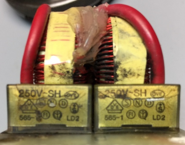

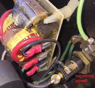

Is it possible to determine an appropriate replacement based on these pics? and would it be prudent to replace the other 2 next to it?
I have contacted the manufacturer but don't expect any help from there. L&R T28B ultrasonic. Any help would be, well, helpful, and appreciated.
A common noise suppression configuration uses an X class capacitor across supply live and neutral, plus two Y class capacitors between live & earth / neutral and earth.
eg. **broken link removed**
The two blocks on the left will represent fuses.
I suspect the blown part is an X class cap. If it is, tracing the connections should show it connected directly across the mains input (after the fuse).
The 250 still visible is presumably the voltage rating; many are now 275V rated, just go on physical dimensions to find the largest value that will fit in the existing space with 250V or higher rating.

Would I need to run a jumper across where the capacitor was? I have to say with electronics, a lot of the time what I think makes sense is completely wrong.
I removed the exploded capacitor, and here are the 2 adjacent. Are the cracks an indication that they are on their way to failure as well?
Or could they go on indefinitely. They don't appear swollen, (possibly just very slightly). I will reinstall this board tomorrow and see how it goes without. On a side note would this be the appropriate forum to discuss spark suppression on a late 19th century electric clock? The main problem with this clock is carbon buildup on the contacts (Hipp toggle system)
Do NOT replace any capacitor with a shorting link.
In this case that would result in a dead short across the mains supply.
Those capacitors should be replaced.
The replacements should be " Y rated ".
