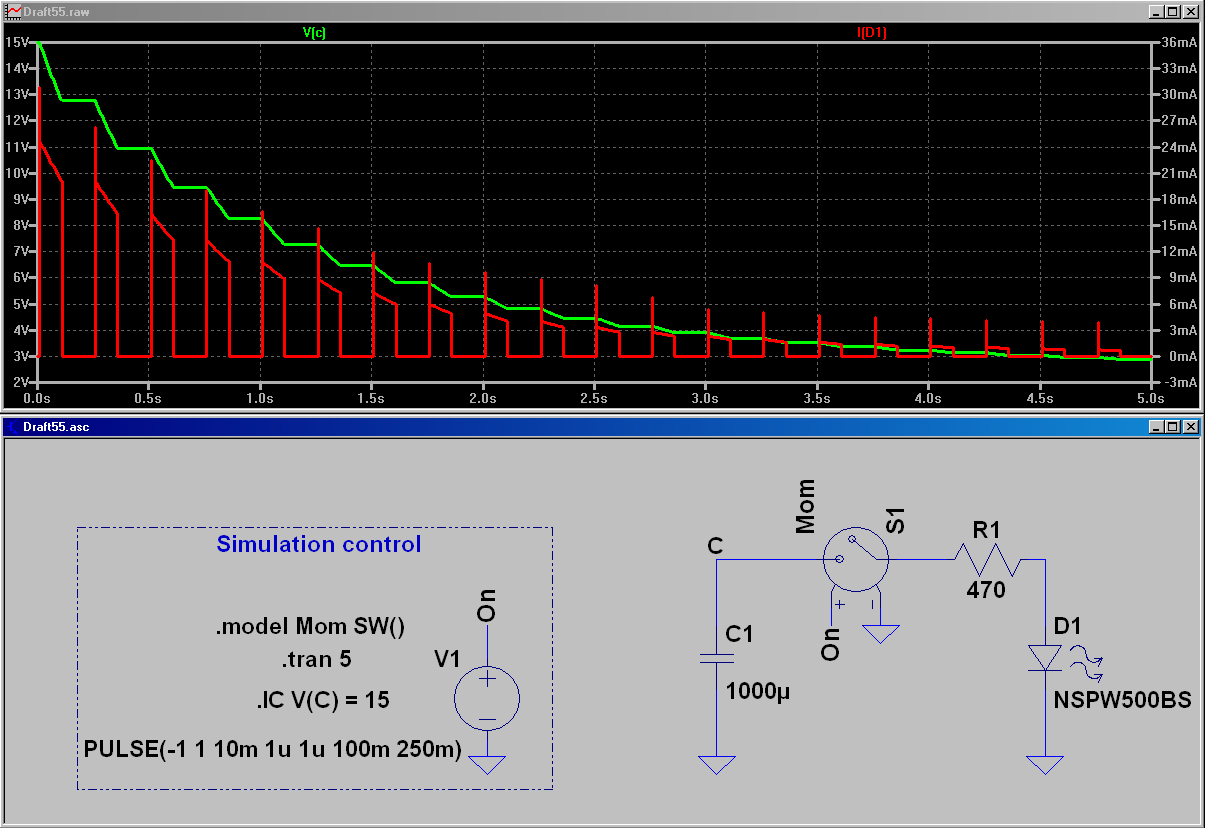

The idea has a major flaw. Each subsequent time the switch is closed, the current through the LED is smaller because each pulse leaves less charge in the capacitor. Look at the plots of the remaining capacitor voltage, and the current though the LED each time the switch closes....
