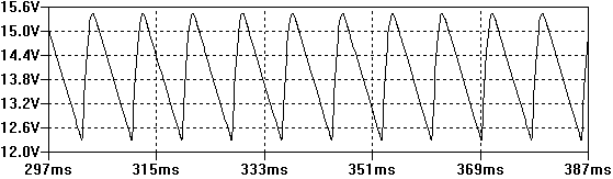

I ran a simulation with transfomer (0-12V) + bridge rectifier + 1000 uF cap + .5A constant load and this is the ripple

I think you should calculate the minimum value of the cap and use that value, e.g, if you find you need 4000uF, and you are going to buy a ±20% cap, buy 5000uF.
