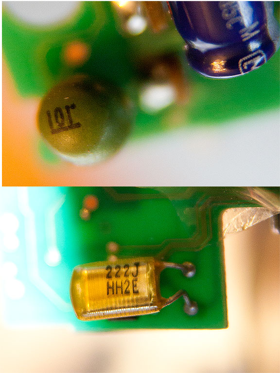

Hello, I am attempting to repair my canon flash, In testing I have located some capacitors that appear to be bad. the first is the green tantalum that is testing at several ohms esr, however I am not sure what the printing is supposed to say? What value should I replace it with? Then again I havent done any previous testing of tantalums for esr, do they normally run high?
the second is the silver mica cap that is testing open, in looking through my junk box for a replacement I found a vcr board with a dozen on it, my question though is that all the similar values are also showing high esr. are they all bad as well or do the silver micas also have high esr's normally?
I was hoping to be able to repair with parts from my junk box and save a trip into town, so thanks for clarifying. Caleb

Well, umm...the green thing isn't a capacitor, it's a 1ohm radial choke...and the silver mica capacitor is in fact a polypropylene/ foil 0.0022uF capacitor unles my glasses need cleaned...
rgds
Thankyou for taking the time to enlighten me, so if the choke is testing more than 1 ohm is it bad or not? as for the cap do I need to use a identical polypropylene/ foil replacement, or can I go for a regular poly cap? I could not decipher a voltage rating from the HH2E code.
For the choke I would expect a resistance reading of anything up to around 8-10 ohms, over that I might be suspicious. The capacitor won't be rated much higher than about 100V due to the size of the pinout, 63V is more likely. Unless it is obviously blown, I suspect your problems lie elsewhere. Check around the discharge capacitor, it will be rated above 200V at 10-20uF, make sure it is charging. Other common problems are transformer windings going open circuit, but quite often it is a broken wire right at the leg due to being bumped around etc. Above all else, be careful where you put your fingers, these flash guns can give you a nasty one...

Thankyou, all the electrolytics are testing good, the choke was about 7 ohms as I recall, and the cap is testing completely open. I am not getting any power to the secondary board so I think the trouble is on the primary power board, although there were 2 broken wires on the ttl sensors when I opened it as well as corroded contacts in the battery compartment. I will check the transformer windings when I get home tonight. thanks again.
Ok then, both transformers test ok as well. I still haven't found a good replacement for the cap. out of the 6 222's I found in my junk bin every single one is testing open. So I guess I will have to go up to the supply house sometime soon and get a new one.
You say testing open circuit, exactly how are you measuring the capacitance?
These caps are itsy bitsy tiny, you won't get much from them, particularly if your fingers are holding the test probes on the leads etc.

I was beginning to wonder if the cap was actually good, I am using an esr meter I built from the Homo-Ludens schematics. when I test with my capacitance meter it is giving the correct value. I found another 3 222 caps today in my junk box and all are testing open with the esr meter. I find the idea of them all 9 being bad pretty far fetched. although the meter tests 223's just fine, I think they may just be too small. I partially reassembled the flash so I could do some further testing and I now have voltage up to the first transformer, I have to mcgyver up a temporary power supply to be able to test it disassembled. I will however get some good pictures up for you to peruse tomorrow. Thank you again for your help. Caleb
