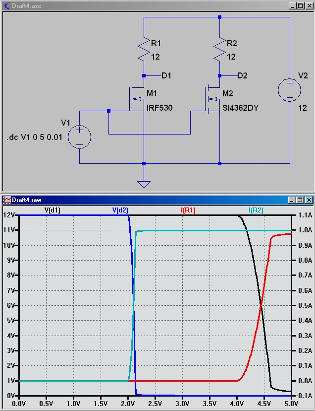

I cannot controll the 3 IRF530's on my second board. That runs 3 12v lights.
I am sending 12v into a board by a voltage regulator (7805) this is sending 5v's to the Picaxe board. I have picaxe outputs that connect to the lights on the second board. When I program the output to come on and off on the picaxe board nothing happens, the light always stay on they only go off when I switch the mains off. How can I control when the lights go on and off?

A better NFET will help.

The IRF530 Mosfet is guaranteed to turn on fully when its gate to source voltage is 10V. Some barely turn on with only 5V.
You need a "logic-level" Mosfet.
Or a couple extra transistor to level shift.
