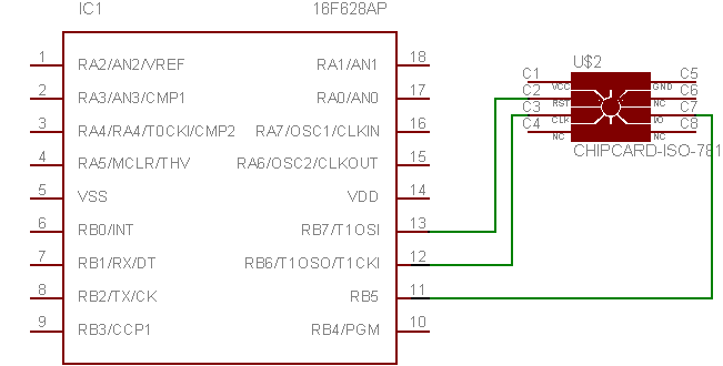

Can we use PIC to provide clock signal for another PIC? the clock signal generated by 1st PIC may not have the duty cycle of 50%.

Actually I am trying to interface a SMART card. As we know, smart card contains a uC as well. Some one even use PIC to emulate the smart card.
The smart card has one IO pin and one ClK pin.
I connected the ClK pin like the one shown.
Initially, every time i send a bit, i will send a clock pulse (PIN_CLK = 1, then PIN_CLK=0). But this doesn't work. Maybe because the CLK is not 50% duty cycle.
The start up sequence for Smart card is stated in iso 7816-3, in the section ISO7816 3.2.b - Reset of the card
https://www.cardwerk.com/smartcards/smartcard_standard_ISO7816-3.aspx
I send the pulses however, The IO pin always high.
That's make me thinking of using another XTAL for the smart card. The problem is, if I use another XTAL, the timing become hard to follow as I am using CCS PIC-C.
I found a smart card Interface IC driver, writen in C. I guess this is possible to use PIC-C to write the driver.
http://www.gemplus.com/products/gemcore_chipset/resources/reader_driver.html
I am using NCN6001 from ON SEMI. Initially I wish to use Gemplus IC, since they have a C driver. but unfortunately, they ignored my request for IC and eval board :)
The fault.png shows my initial connection to smart card. PIC supplies clock and rst signal to the card, and use 1 IO pin to communicate between the smart card.
In the real connection, I use NCN6001 smartcard reader IC in between PIC and smart card. NCN6001 is a voltage level shifter and also it can divide the clock signal to 1/2 or 1/4 by flip-flop. This can provide a 50 % duty cycle to the smart card. smart card requires 40-60%. I purposely didn't include the NCN6001 because I dont want to make the schematic messy.
Initially, since we supply the clock signal to smart card IC, I do it in Synchronous way. Every time i want to transfer a data, I set the IO bit and then follow by a clock pulse (fault.png). I thought the operation of smart card is depend on the pos edge of the clock signal. But it doesn't work. (the target smart card is using Async Transmission)

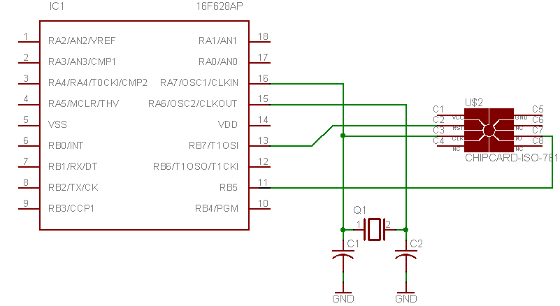

Then I check again with the reference design. the reference design is using 68HC908 as uC. the smart card and uC share the XTAL of 19.6608MHz. so I modify my schematic (card share clock.png).
The way we program uC is serial programming. It makes us easy to code Synchronous transmission. For Async transmission, It will not that intuitive to code that. As the matter of fact, I am having problem with that. The reason is, I never use PIC assembly language before, i use CCS PIC-C to code it at the very beginning.
I modified the connection as shown in "card share clock.png". I only have 8MHz Ceramic Resonator at hand.
I hope can find the technique to code Async Transmission, preferably in C (I know this is not the proper way to code uC without the strong Assembly basic). I guess RS232 is kind of Async Transmission protocol, so if any one can provide RS232 protocol in C would be nice. CCS PIC-C has a built-in rs232 function, I use it all the while, and I don't know what's happen in the background.

You should be connecting to the CLK_OUT pin, NOT the CLK_IN pin, remember - you're coming OUT of the PIC and going IN to the card processor.
Depending on the load imposed by the card, you may have to insert a buffer between them - obviously it depends entirely on the card processor.
