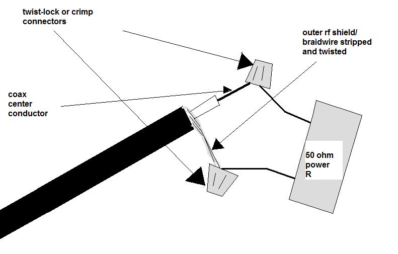

You don't need to purchase an attenuator. A 50 Ohm resistor will do plenty of you are just planning on a simple neighborhood transmission.

You will not have to cut your coax. You can get a short 50 ohm piece of coax with an RF connector already soldered on at radioshack. Be sure the transmitter wants 50 Ohms, it will indicate the antenna impedance on the back. Some cases it might want 75 ohm coax. In that case you would need a 75 ohm resistor for the dummy load.
If you are uncomfortable with soldering, twist wire connectors or crimp connectors could be used to secure the resistor to the coax without much trouble. You could make a very efficient attenuator yourself for less than $15 that will actually keep you legal, or at least legal enough to not worry about anything.
Here's a little drawing to help you out.
All you have to do is strip back the outside black,grey, or white insulation from the outside about two inches. Then, unravel the braid wire down to the edge of your cut insulator. You will expose the center insulator, which is usually rigid white or clear nylon plastic looking material. cut this back about an inch, leaving the solid (usually) or twisted copper center conductor about an inch exposed.
Make sure the braid nor center conductor have a chance of touching and shorting out. you might hotglue them to a piece of plexiglass or tie wrap them in place to a piece of wood. Something nonconductive. Use the twist-locks or crimp connectors as I have illustrated to install the dummy resistor.
I urge you to take precautions like this and not haphazardly transmit an illegal signal. The commercial fm band in particular is NOT a good place to do something illegal. Too many people with radios tuned to that band.

And as far as the resistor for a dummy load goes, all you need is one rated for above 5 watts...next step up is 10 watts...and 50 ohms. 50 ohms is not optional. This is like impedance matching a speaker for your stereo. If it says 8 ohms on the stereo, you need 8 ohm speakers. Antenna is the same way. A resonant antenna for 100 MHz will present 50 ohms to the transmitter. A dummy load has to be the same.

The reason thick film power resistors are used is because they present nominal reactance to an RF circuit. A wirewound resistor can become inductive at certain frequencies and isn't a good idea.
That PDF points to part numbers that should be available for 50 ohm resistors, Check and see. If I were you, I would research the same variety of resistor in higher wattage packaging if available.
The heatsinking he presents would be overkill for a <5 watt application. However, heatsinking to SOME metal piece would be required to dissipate heat. A small aluminum block with holes drilled through it would do the trick to increase surface area. Make sure to not allow the legs to touch metal or each other. Heatshrinking would be a good plan.
Soldering the connector as I mentioned or using twistocks is still an option.
You won't need another power supply here. The resistor will be turning most of the power into heat. It will radiate however. Trust me. Not sure how far you need this to go, but a 100 foot radius is not unlikely.

My reservations with the dummy load are being able to find the coax ends and being able to crimp them. I've never done those types of connectors before (only cat 5 for network cables).
