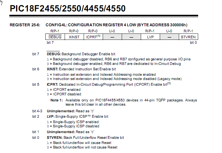

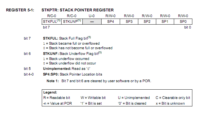

Isn't that a fuse option on 18F' devices, where you can either reset the device after a stack overflow or just rollover the stack pointer after a stack overflow?
hi Mike,
The STACK OVL can be tested or directed on the 18F2550
