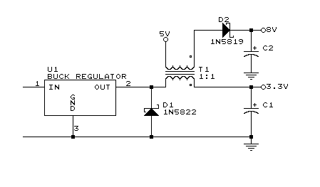

The National Semi device LM2717 could almost fit the design parameters you listed. It's a dual DC/DC converter chip. However, it is designed to supply 1000mA @3.3V and 1500mA @ 5V. It is possible to swap the outputs so that the higher current one supplies 3.3V instead.
As for the third output, The output current is low enough that you can add a secondary winding to the 3.3V regulator (wound with approximately 1:1 turns ratio) so that it supplies 3V when rectified with a shottky diode. This will ride on top of the 5V rail to get 8V.
The LM2717 operates at a fairly high frequency range of 300-600Khz. You don't need much inductance. A small ferrite core with an air gap (to keep it from saturating) should be enough. I wouldn't worry too much with the transformer design. There are switcher design helper programs (SwitchCAD from Linear for example) to help with the design.

There is a problem with any forum (of which you are no doubt aware): not eveyone who replies knows what they are talking about! Motion has the right idea, but the schematic won't work. If there is no load on the 3.3 volt supply, the 8 volts becomes 5 volts. You DO need a transformer with multiple taps!
You're right. I forgot to specifically mention that the circuit needs a minimum load at 3.3V output to obtain 8V. I don't think it's a serious problem given the relatively low 50mA load requirement of the 8V rail and the high 1500mA requirement for the 3.3V rail.
The circuit I recommended is a practical one. I've used it on an actual commercial product. And I am not the first one to recommend it. There is similar design found in the Maxim-IC triple supply evaluation kit. See the ff. MAX782 datasheet.

Wait-a-minute... I'm confused now. :oops: In your previous post, motion, you talked about the LM2717. But it seems as though you posted a schematic for a different chip... because it's only showing three pins. Is the chip in the schematic you posted nothing more than any 3.3V buck regulator (that can supply enough current)? Or is it the LM2717?

Alright. I think I've got it. What would you guys think if I followed Figure 13 on this datasheet for the 3.3V and 5V, then followed the schematic on the first page of this datasheet for the 8V?
Yeah, I think it will work. You have to supply the 8V circuit from the 3.3V output. It ain't pretty but with just 50mA load, I think it's alright. At least you won't have to worry about sourcing transformers.
BTW, I think you mean figure 12 of the LTC1143 datasheet.
