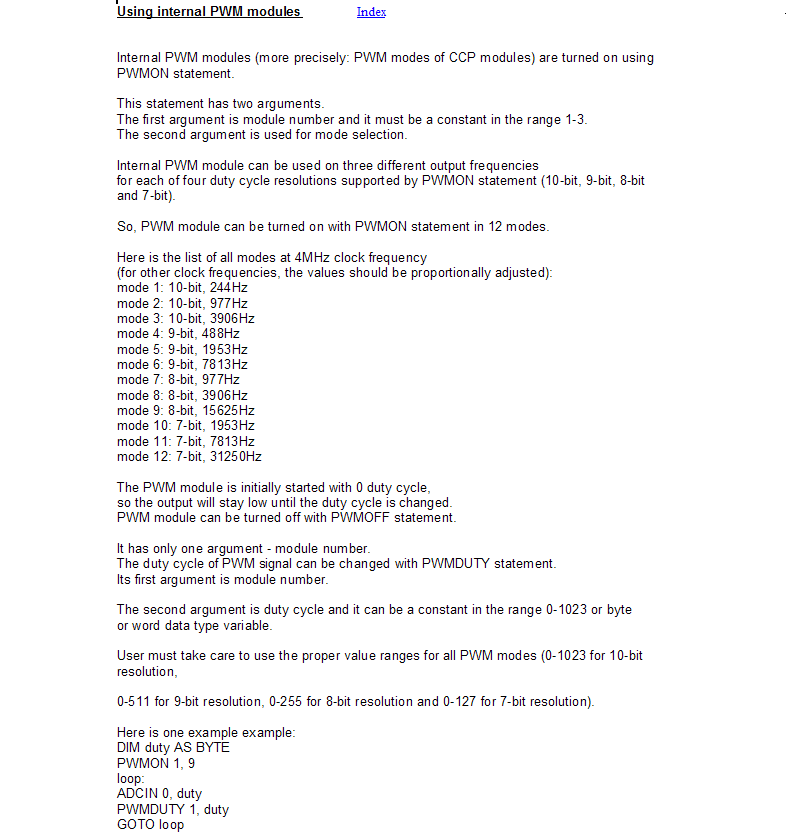

Dear all,
I want to bring out a PWM signal to gate 6 of a PIC 16F628A.
I have the following code written.
Can someone help me?
P.S. this code is first written in Proton, I'm trying to convert it to oshonsoft.
In proton you can use the PWM instruction for every port, I hope this is also the case with oshonsoft?

Oshonsoft Basic uses the internal hardware PWM on RB3.
E
it has a number of bit count and freq options, 2 examples
PWMon 1, 9 '8bit 15625 hz
''PWMon 1, 3 '10bit 3906
PWMduty 1, duty
Look at this page from the Oshonsoft manual.
PWmon set the PWM module number [ 1 only on your PIC], second digit sets the options , see the image.
so, PWmon 1, 9'' module 1 option 9
PWMduty 1, duty ' sets the PWM duty cycle.
