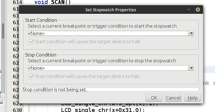

You sure Mike, stopwatch seems ok whenever , runs between breakpoints ? on my puter and shows cycle count
gives cycly counnt

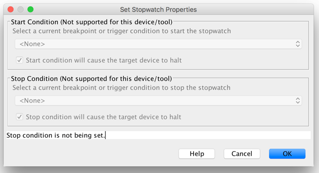

Thanks for pointing out the Stopwatch tool. Unfortunately, when I click on stopwatch properties, everthing is greyed out and it says "Not supported for this device/tool"
Anyway, it appears that the cycle counter in my Basic simulator is accurate after all. After adjusting the code to give the required 999997 cycles in the Basic simulator, I loaded into the PIC and ran it. The timing appears to be correct (or very close). I'll need to do more testing to make sure.
Update:
Even though the stopwatch properties window can't be configured, the stopwatch is working. It shows the accumulated cycle count whenever a breakpoint is encountered. That should be all I need.

So, now I'm combing through program code examining the parts that are different between the 1 ms counter, and the 1 s counter. There's not much to look at because they share most of the same subroutines.
Further update:
Digging through the Microchip site, there is indeed a verified bug in the MPLABX simulator where it counts cycles incorrectly. Apparently, the problem is due to the MPLABX simulator using the published info in the various processor datasheets. It turns out that the datasheets are incorrect in specifying the number of cycles for certain instructions that alter the program counter. Since my own Basic simulator also uses the info from the datasheet, this explains why it agrees with the MPLABX cycle count, and my hand calculation.
Apparently, in MPLAB 8 they based the cycle counter on actual hardware design info instead of the published datasheets, and so the MPLAB 8 simulator gives a correct count. I don't have a copy of MPLAB 8 to test this with, but I'm going to assume that this is the cause of my problem. I'll add 736 cycles to the delay routine, and call it fixed.
Your code does not initialize the dlyctrL variable to zero prior to the first call to the delay subroutine which could affect your very first count. The dlyctrL variable will always have a zero value after the delay subroutine uses it.
