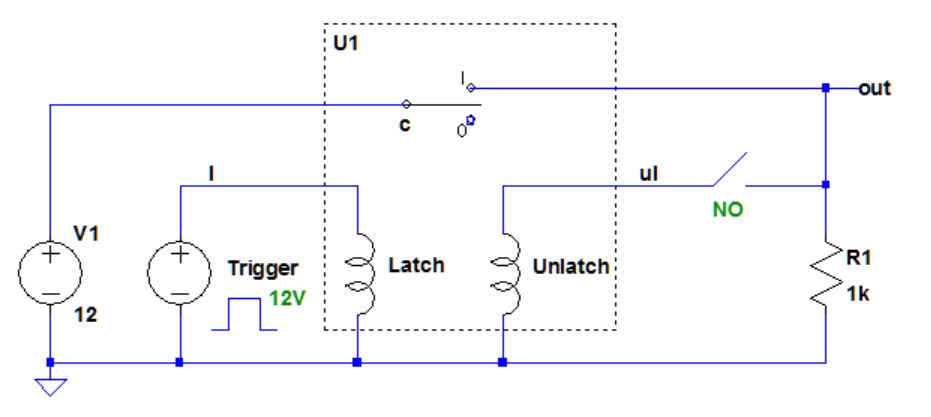

Here's how you could use a dual-coil latching relay to provide power to a switch which, when operated, will remove power to itself. Is that the sort of thing you mean?
A latching relay is a bistable operation which latches in each direction.
Agreed (if by 'in each direction' you mean remain set and remain reset, until the appropriate coil is pulsed).
So why do you think the post #22 circuit won't work to provide power to the NO switch from the time the latch coil is pulsed briefly until the time the NO switch is closed momentarily to energise the unlatch coil? I'm assuming (perhaps wrongly) that when the unlatch coil overcomes the latch permanent magnet and begins to flip the relay armature, then armature inertia plus the coil pull will continue the unlatching action until the relay contacts supplying the NO switch open, thereafter the armature inertia plus the unlatch permanent magnet pull will take over to complete the unlatching. Is that assumption incorrect? I admit to never having tested it in practice.
