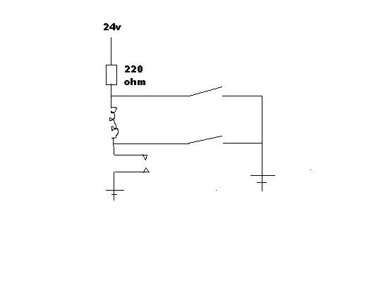

Pin 14 is connected to 24 volts via a 220 ohm resistor and pin 13 to pin 9 and pin 5 to earth this will act as a latching relay if I touch pin 13 to earth and then pin 14.
I want to delay the relay from closing for about 1 to 2 seconds after touching pin 14 and open the instant I touch pin 13.

Post a schematic of your hookup or at least a link to the data sheet for the relay you are using.

Is this enough? I don't have data sheets the relays are already in place.

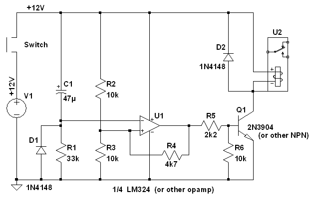

I think fig 2 would work if I put a relay contact as the switch on with the n/c to earth and the n/o to the 24 volts (with small alterations in component values) and my relay instead of the opto coupler?
but I think there must be an easier way?
Would someone mind pointing out how I could extend the delay, I think it is about 200 millisecs at the moment with these components.

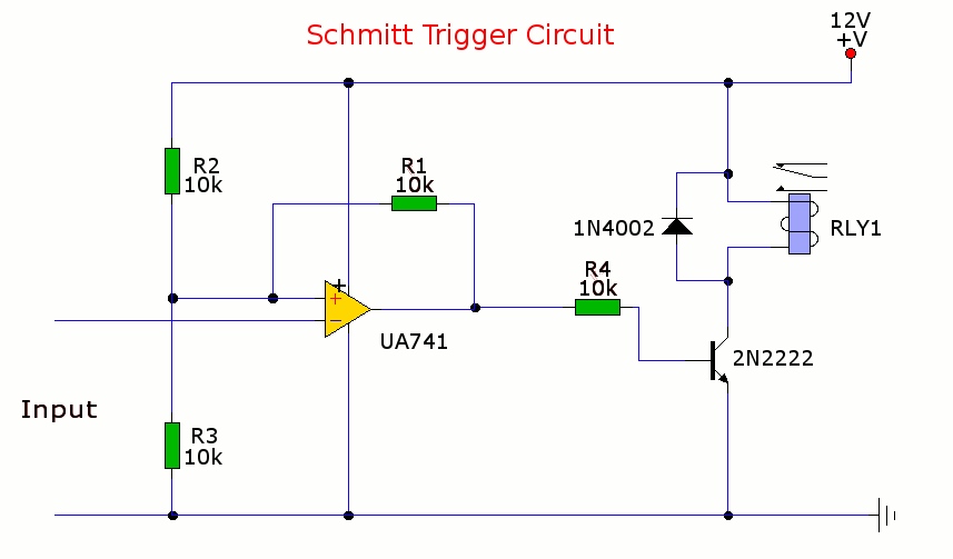

If you replace Q1 with an N-FET, and use a CMOS Schmitt circuit between the RC components and the FET gate you could raise the value of R1 considerably to increase the delay to several seconds. A freewheel diode would be needed across the relay coil. Ideally the relay contacts already have a snubber?

Would this suffice do you think with r2 replaced with a 22k and r3 with a 100 μF capacitor?
I am not familiar with n-fets? do you mean an n channel mosfet and if so which would you recommend? I would prefer the circuit to run from 24 volts.
The feedback resistor R1 would be discharging the cap. The circuit could be re-configured easily to do the job. A more modern opamp might be better than a '741. Yes, I was referring to an n-channel mosfet. Almost any one would do here, but the bjt shown would be ok if driven by an opamp rather than CMOS.

Here's the reconfigured post #8 circuit:

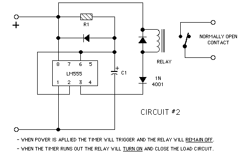

I am searching a solution for this question for a long time but this section helps in getting the solution for the problem. Time delaying capacitor is used for discharging onto the coil once the trigger current is off and thanks for the answers given in this section. Use this for future reference https://www.vicky.in/shopping
