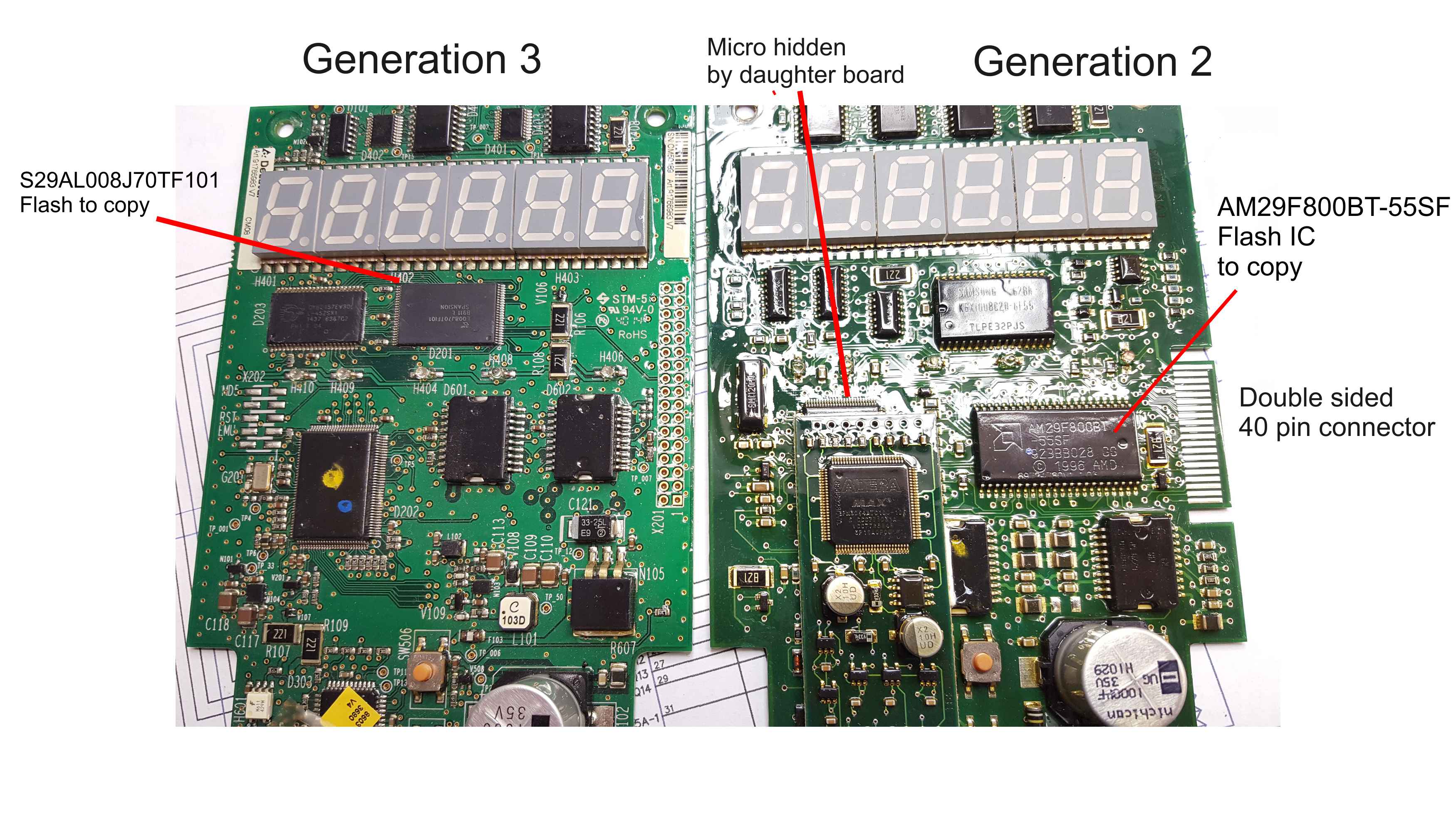

Wondering if anyone can help me please.
I need to copy a flash memory IC … an AM29F800BT-55SF ... 8 Megabit Top Boot Sector Flash Memory IC … SOIC44 package.
Can I copy one that’s still on its circuit board?
Of course if I power up the board that it’s on … the micro is going to take over … but if I hold the micro in reset … could I then access the flash memory chip maybe?
Or do I allow my programmer to supply the 5 volts for the flash memory ... and still hold the micro in reset.
Do I need to make sure Chip Enable and Output Enable are set perhaps … then read it with my usual programmer?
All the pins on the flash chip also run to an edge connector on the board … so I can access them reasonably easily … though there seems to be no real order to them!
I don’t need to program them in-situ … once I have the data I’ll program them in a proper programmer and solder new ones in … I just need to have legit data to start with.
I can't remove them easily ... they have a conformal coating and my usual way of removing them is to cut the legs off and them hit them with a hammer and screwdriver to break them free of the board. :eek: I know, I know ... butchery!!!

I probably should attempt to remove the flash chip ... but then if I stuff it up ... I'll have ruined a good board as well as have a dud ... and still not have the firmware for the next one.
The board is conformal coated and while I did once remove one of them intact (from a 1st generation bd) and got it to read in my eprom programmer ... I still get heart palpitations any time I think of doing it again.
This request is for a 2nd generation board ...
... but I already have a 3rd generation board I need to do as well ... and that uses a S29AL008J70TF101 flash chip … with a 48 pin TSOP package. Smaller legs and finer pitch. I'm not feeling so well. :)

The biggest issue is that the coating material gets under the chip and sticks like super glue. I can get the coating off the pins and re-tin them ... but to lift them all up off their pads without wrecking some is nigh on impossible.
Then, as I mentioned in another thread ... I have to use a hammer and screwdriver to tap the body off the board.
Maybe the Toluene will soften that bond if I leave it long enough. :)
I ordered a hot air desoldering system a few weeks ago ... it's on a slow boat from China ... maybe I should wait for that. Then after practising on some sacrificial boards I might be more confident.

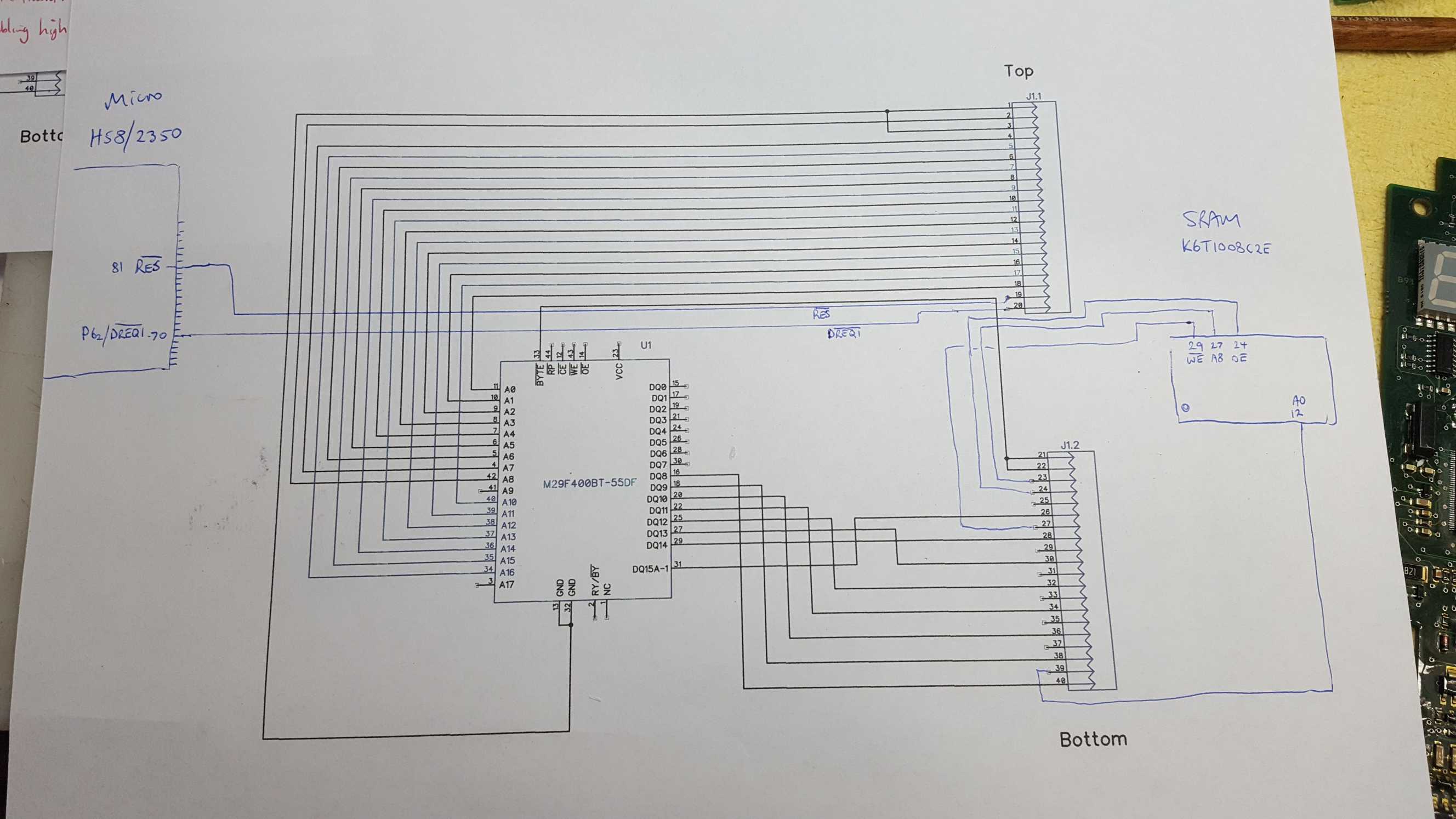

I hadn't fully completed the diagram of the edge connectors to the flash chip ... but now that I have ... I'm more confused than before.
All except for A8 and A17 of the address lines are connected ... but only half of the data lines DQ8 thru to DQ15 are connected.
There is a connection through to the micro RESET pin ... and to pin 70, P6-2/DREQ1
Then there are a couple to the SRAM chip ... see cct
And none to OE or CE ... in fact I couldn't find any direct link with them to the micro either!
DREQ1 is tied up with the on chip DMA Controller (DMAC) and Data Transfer Controller (DTC) ... which enable high speed data transfer without CPU intervention.
I spent an hour or so reading (and half an hour sleeping) in front of the datasheet ... 988 pages!!! ... DMAC came up 599 times in the search CTR/F ... several hundred pages ...
It's obviously a big part of the micro's capabilities ... but I'm none the wiser.

Edited to provide better images (I hope)
Then I would guess the connector is used for some sort of address space expansion, and you can´t really use it to read the flash.
That shiny colourless coating looks like stuff I've encountered before... try heating it with the hot air and flaking it away with a jewler's screwdriver or similar. After some practice (on some scrap boards!) with the hot air, I reckon you stand a pretty good chance of getting that flash IC off intact. The ones with pins on all 4 sides are harder, as you've no-where to grip and you really do need to get all pins unsoldered simultaneously. With those you can do a bit of heat one side, ease it up, heat the other side, ease it up, etc. You're far more likely to lift a pad off the board then to damage the IC... you can only afford to lift a minuscule amount.
Remember you can buy adapter boards for a lot of surface mount ICs (don't know about that type specifically though) which would make a nice breakout - far easier to deal with than trying to solder fine wires to those pins.

I've had a good 10 years experience with conformal coatings in general ... the stuff is a pain in the butt for most repair work ... and 95% of the boards I work on use it!!!
I've developed a whole heap of techniques to deal with it ... particularly a number of home made scrapers and abrasive tools ... but combining them with hot air is new for me.
The desoldering machine arrived this morning .. a Quick 8610W. Couldn't resist playing with it for a couple hours and lifted ICs and all sorts of smds off some wrecked boards.
Of course these were uncoated boards and I was amazed how well it works. Dunno why I waited so long to buy one.
Anyway, I had to try it on the memory chip in question ... but I did spend quite a while cleaning the coating off the pins before I did anything else. In this case it was doubly important because I need the pins to be clean and straight enough to go into an adaptor and connect properly without having to scratch and clean pins once it was off the board. That's when I break pins or spend ages trying to get them all to contact.
Was a bit of an anti climax really ... I had to get it pretty warm ... and keep a bit of pressure under it to break it free. It certainly still was the paint under the chip body that kept it from coming loose easily ... but it came off well.
Went straight into the adaptor and read off the code with no trouble. Now I just need the new chips to see how it goes.
I didn't want to stretch my luck yet by tackling the TSOP48 chip ... I'll try that later. Those pins still look too fragile for me.
Yeah, I'm at a loss for what it might be used for. I was sure it was for initial loading of latest firmware for the boards before they were coated.
The crazy part is that I could upgrade the firmware using a stand alone processor that's used as a controller in the dairy ... but it requires the flash chip to have a boot program loaded on it already.
... and if I fit a new blank chip the boot section is not there ... so my processor can't 'see' it.
