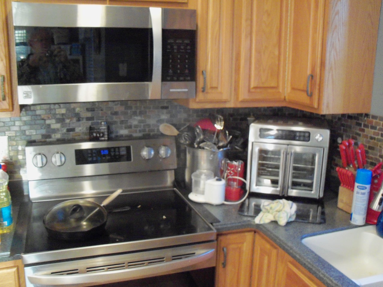

How can I test our factory microwave for leaking microwaves?
Will a 30 turn toroid with a LED work as a leakage detector?
Will a 30 turn toroid with a LED light work as a microwave leakage detector?
No; a toroid is supposed to be inherently free of field leakage.
The primary effect of leakage would be a feeling of warmth, as the RF is dissipated in your skin as it would be in food, to cause heating. I don't think dizziness would be a symptom??
If there is no physical damage to the microwave and the door closes correctly, leakage seems unlikely.
Any significant leakage would likely swamp any WiFi device, as they are on similar frequencies.
Is you phone WiFi signal affected by starting the microwave with the phone close by, compared to the signal in the same location with the microwave off?
Considering the stupid things you do, a microwave oven is the least of your concerns
However, I've tested thousands of microwave ovens (in my previous career, which included repairing microwaves) and leaking ones are almost entirely unknown - I've only ever seen two which leaked, both the same make and model, and both were within UK legal limits.
If you feel dizzy, then you're imagining it, it's nothing to do with a microwave oven, leaking or not.
As regards leakage testing, unless you buy a professional calibrated tester (which requires calibration yearly) then it's a waste of time.
I could have taken the leakage tester when the company closed, but I saw no point - testing at work was a legal requirement, but I've never had any urge to bother testing mine. Generally a simple physical inspection will show if the door has been badly damaged, or badly out of alignment.
