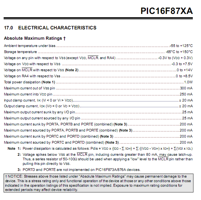

For the current required for the PIC16F877A, what I did was I connected the power pins (Vdd and Vss) of the PIC to an ammeter in series to a power supply and measured the current consumed. Would this be the correct method of measuring the current required for the PIC?
The datasheet states that each PIC pin consumes current of 25mA but im getting an overall consumption of 25mA.

If the PIC pin is rated at approx 25mA, that means that it can source or sink up to 25mA.
The actual current will depend upon the actual load.
ie: a pin set as an output with no load connected would draw no current.
a pin with a 200R to 0V would draw 25mA from the pin
A 7805 is recommended, many adaptors are poorly regulated.

The pins are rated at 25mA before they can be damaged. An incorrect circuit (such as a direct connection to 0V) will draw much more than 25mA. It is your responsibility to design circuits that do not ask for more current than the rating.

I was working on the assumption that the OP didn't understand some of the terms in the data sheet and might think the uC took care of the current limiting.
According to the datasheet, the whole MCU can sink 300mA or source 250mA but the maximum per pin is 25mA.
