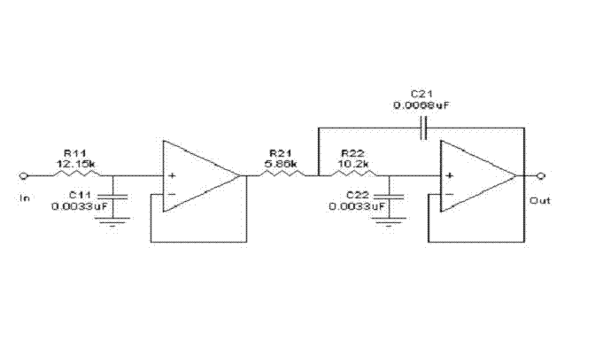

Hello,
Im having a nightmare with this I can't find the answer anywhere. Basically im looking for the formula to calculate the 3db point of a Bessel 3rd order sallen key filter. I need to test the circuit with various different component values, I just want a formula I can put into excel then easily calculate a number of different variations.
I know this,
1st order 3dB = 1/(2piRC)
2nd order 3dB = 1/(2pi*sqrtR1R2C1C2)
3rd order 3dB = ???????????????????????
I need to know the effect of component tolerances on the filter performance, any help would be very much appreciated, there's a picture of the circuit attached.

Here's both.
This circuit has a 3dB point of 3Khz, but I need to test it with components that are +/- 10%, 5%, etc...

Ok thanks, I was hoping the answer wouldn't include transfer functions, I did come across them in my search for an answer but they make no sense to me. I try to avoid Laplace transforms like the plague.
Firstly my circuit uses 2 opamps, but the one on that web page uses only 1, will the equation still be relevant to mine?
Secondly, what is T(s)? and what is s? and how does this equation help me calculate the cutoff freq?

one quick question, there is no mention of the resistor values in this equation, but when I simulate the circuit and change the resistor values it does have an effect on the 3dB point, do i need another equation for this?
ok i've added in the values that I know and w^2=W and I get this horrible looking thing
5.483698704x10^-51 W^3 + 4.5467928x10^-33 W^2 + 3.8217x10^-16 W + 1
can I just stick the values into these equally horrible looking formulae?
https://en.wikipedia.org/wiki/Cubic_function#General_formula_of_roots
Hi again,
Yeah ha ha i just noticed that a minute ago too. Yes, you'll need another equation. There is one on the web but i have not tested it yet.

my dreams of a simple solution to all this are quickly evaporating. Before I go any further, will I need this other equation instead of the one i've been doing?
Oh yeah, thanks for all the help, it is very much appreciated.
Just found something very curious, my 'a' value = 5.483698704x10^-51, turns out that when you square this the answer is 0, seems like anything to x10^-51 squared = 0
Hi again,
You mean the other solution for x? You can use that one or use the one from the web, but if you use the one from the web you should test it to make sure it works. Now although that equation may be accurate, i have found many many equations on the web that look good but are not accurate.
It's not too bad though, because you end up with a 3rd degree equation to solve. Be happy you didnt end up with a 4th degree equation :)
The way this would be done normally is we would use the computer by creating a program to calculate this over and over again, or use a programmable calculator which may actually have a third order solver built in.
Note that once we have the solution and it is programmed into something it's real easy to calculate it over and over again to test with new component values.
There are free computer languages/compilers out there with relatively simple programming languages. You could use one of them if you like. There is one called simply "Euphoria" which makes programming some math problems like this not too hard to do as the syntax for simple programs like this is quite simple too.
If i get a chance today i'll double check that formula for the SK low pass filter with all the R's and C's included.
