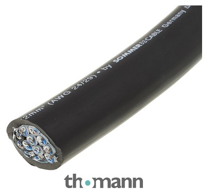

You can get multi pair video cable for studio use - eg. 8 or 12 pair; eg.
