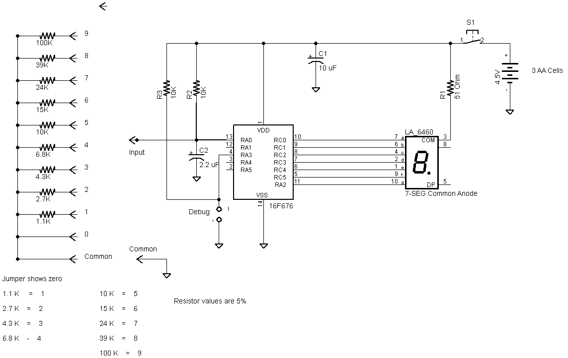

If you are talking about identifying wires in a bundle I have a circuit I built sometime back that does this. It uses a remote box that contains 9 resistors, 11 leads with alligator clips come out of the box. One is labeled common and the others are labeled 0 through 9. A common wire is needed between the ends of the wire run, the common lead on the remote box and on the readout box connect together through this wire. When the input lead on the readout box is connected to each wire in the bundle a 7 seg. display shows the lead number it connects to at the remote unit.
