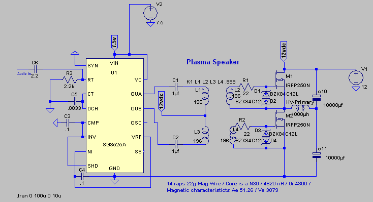

Ok, I hope I did this right. Check it for error.

I don't have a symbol for the SG3525, so I can't check those connections, but C1 and C2 will block the current that needs to flow in the two sides of the primary. They would be needed if the outputs of the SG3525 were current sourcing/sinking. But since they sink current only, they need to be DC coupled to the transformer windings.
The value for the four inductors should be the inductance of 900uHy.
900uHy can't be input in the Spice (Edit Transformer winding) etc. Showing
Inductance, series resistance, parellel resistance.
Or can I use 900uHy?
I will remove C1, and C2. But, just to be clear on the value of the inductors, what should I use for (H) in post #14 or how should it be written in a Spice model .999 maybe?

Looking over the Schematic I named the coils wrong, it should be correct now. L2 and L3 were not correct.
  • My first LT Spice Drawing final.asc
The 10,000uF caps; you have the value and name reversed.
Need a voltage source or two.
FET2 gate drive transformer not connected.
RT goes to gnd.
CT goes to gnd.
I do not understand why the OSC is not working. It has been 10 years and my memory is bad.
It looks like you want to make a class D audio amplifier.
Go find a power supply design that works. Connect the OSC and soft start parts correctly.
Your OUTA and OUTB are strange. You should not short A and B together.

So, I used 900u and kept .995 in, I removed C1 and C2.

Your core has an Al value of 4620nH
14 turns ^2 = 196
196 * 4620^-9 = ~900uHy for each of your 4 windings.
Add a spice directive (like alec_t said in post #2) of "K1 L1 L2 L3 L4 .995"
The number at the end is the coupling efficiency. 1 implies 100%. A more practical value would be .99 to .995
If you have more than one transformer in a circuit you would have more K directives.
K2 L5 L6 .995
K3 L7 L8 L9 .995
etc.
Series resistance is the DC resistance of the winding. It's not critical for your transformer, but put in 10 milliOhms as a rough estimate. Leave parallel resistance open.
